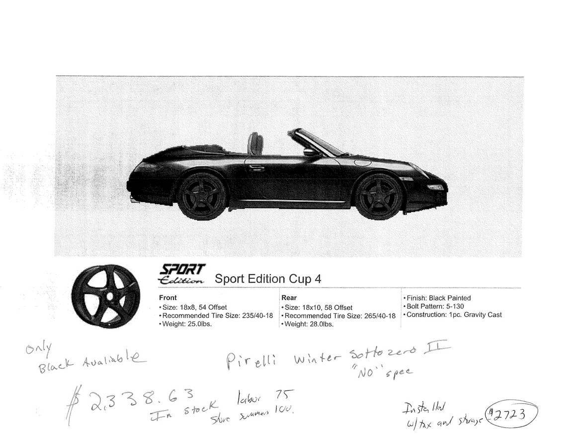

Anyone know if these will fit? TireRack said no because they won't fit the brakes. Any glaring reason you see why I shouldn't test fit? Guy selling them near me on Craigslist for $1000.

What wheels do you currently have? 20inch on the XJ supercharged I'm guessing. Think that model has the extra large front brake calipers. Have a look at your current wheels and see how much air gap there is between the caliper and the inside of the wheel. If you want to go down 2 inches in wheel diameter that's one inch of clear air clearance you'll need btw caliper and the inside of the wheel, assuming inner wheel shape is about the same. My guess is you have less than a half inch so I doubt it's even close. See if you can measure?

I do have the 20" wheels. Yeah Tire Rack said 19" is smallest. I will measure the gap tomorrow and I can always ask if I can test fit I guess. Thanks for the help.
