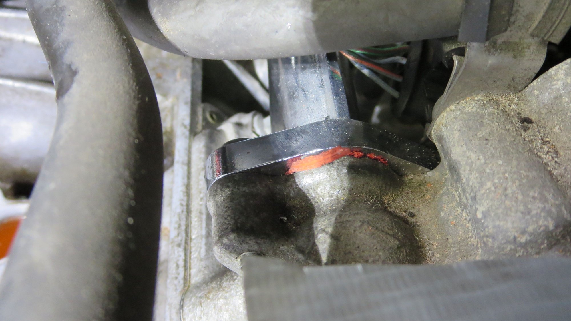

Another problem I cant get the aluminum pipe in Impossible I don't think its the gasket I think its metal on metal Is this normal ? I put a lot of grease still it will not go in
I'm thinking about getting a new plastic pipe from Jaguar and forgetting the aluminum upgrade

Do you really wanna do that job twice?
i used coolant on my O-rings and pushed straight down. Not sure why yours insnt working 🤔 dimensions seems on point with the oem.

Try to smooth off the second camber on the Alu pipe with a touch of fine wet and dry (with o-ring removed so you don't get bits of Alu on the ring)? I found the 'angles' on my Alu pipes a bit aggressive. Once the pipe is in place the 'shoulder' does nothing.
In the end I wimped out of fitting the Alu pipes on the recommendation of my indie who felt there wasn't enough 'mileage' on them yet to recommend. So went for new-style plastic, knowing I might need to do it again in a few years or so.

I ordered another two sets of pipes off Amazon and one finally fit
The original one I ordered off of Ebay did not fit with or without the o rings
The second one I ordered fit without the o rings but would not fit with the o rings
Finally the 3rd one fit with the o rings although not as snug as the OEM

The gaskets on this aluminum heater pipe don't look good only after 50kms of driving It might start leaking soon
I wonder if the dealership sells just gaskets? I can swap
