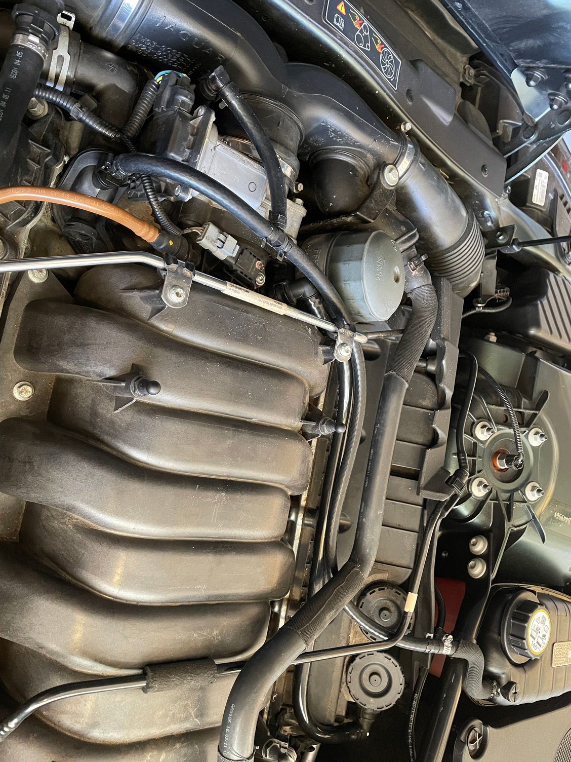

PA12 Cooling Hoses
The problem is that PA12 has a working temperature limit of about 210 degrees, which is close to the coolant temperature on a hot day, or when a hose runs rear an exhaust manifold or oil filter housing. After long exposure, the PA12 starts to become stiff and brittle. That can happen after only a few years in hot climates. Brand new tubing can survive a bend radius of 3”. Aged tubing can literally snap with just a mild push of a finger. It is possible to rebuild a hose assembly,
Coolant overflow hose rebuild with silicone rubber on a 2012 XK X150.
reusing the fittings, but replacing the hose with silicone rubber with the same inside diameter.
