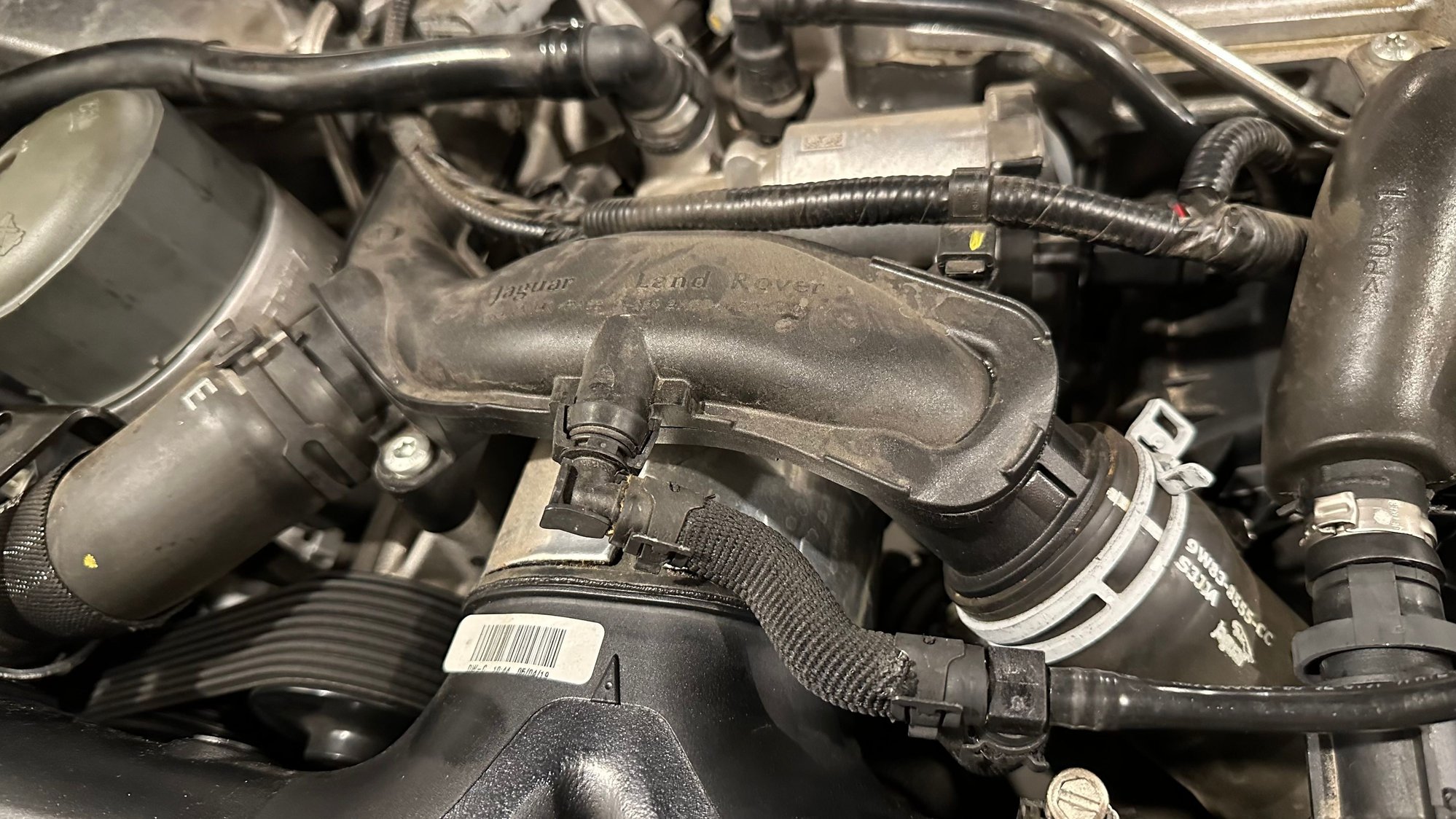

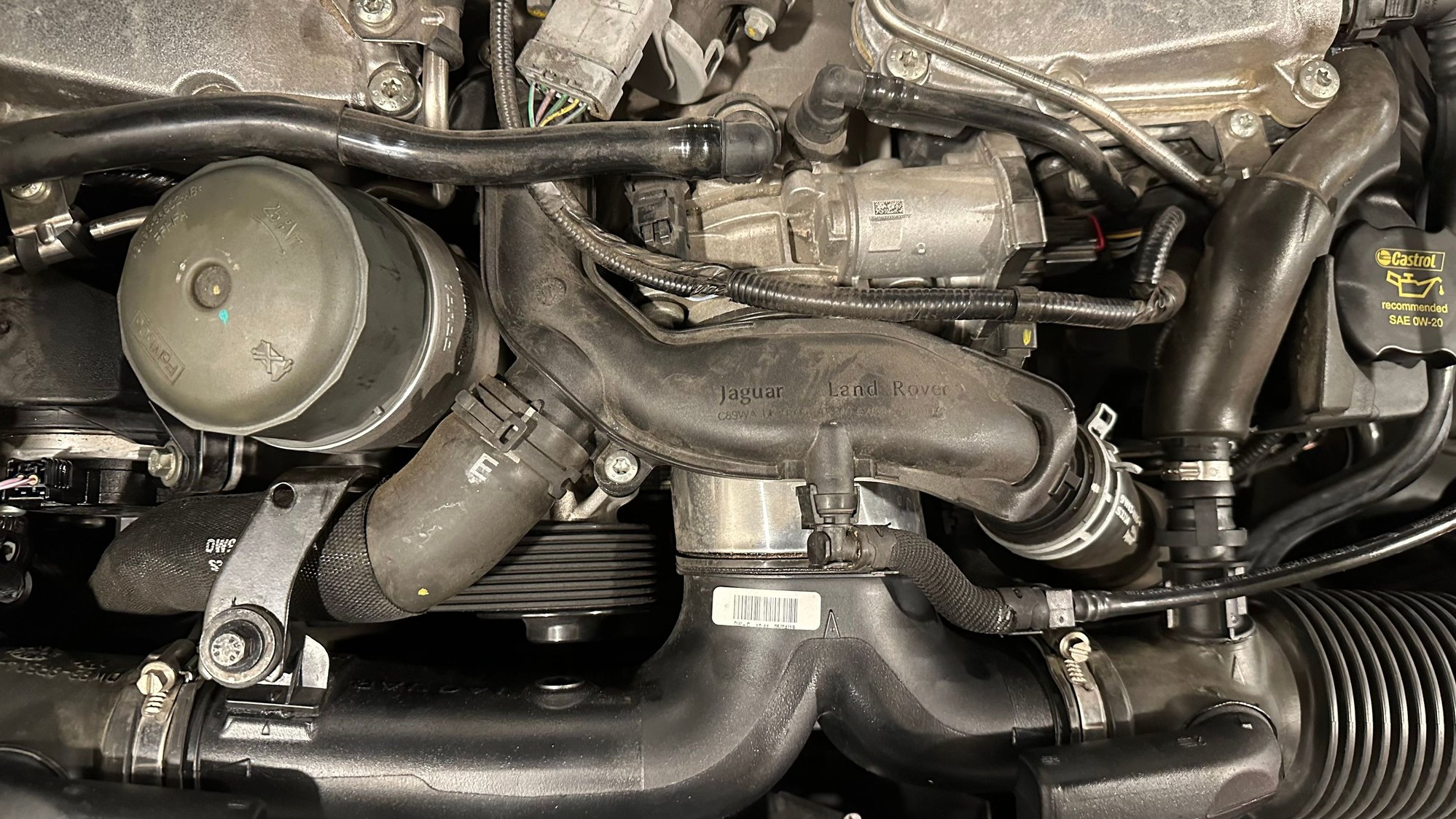

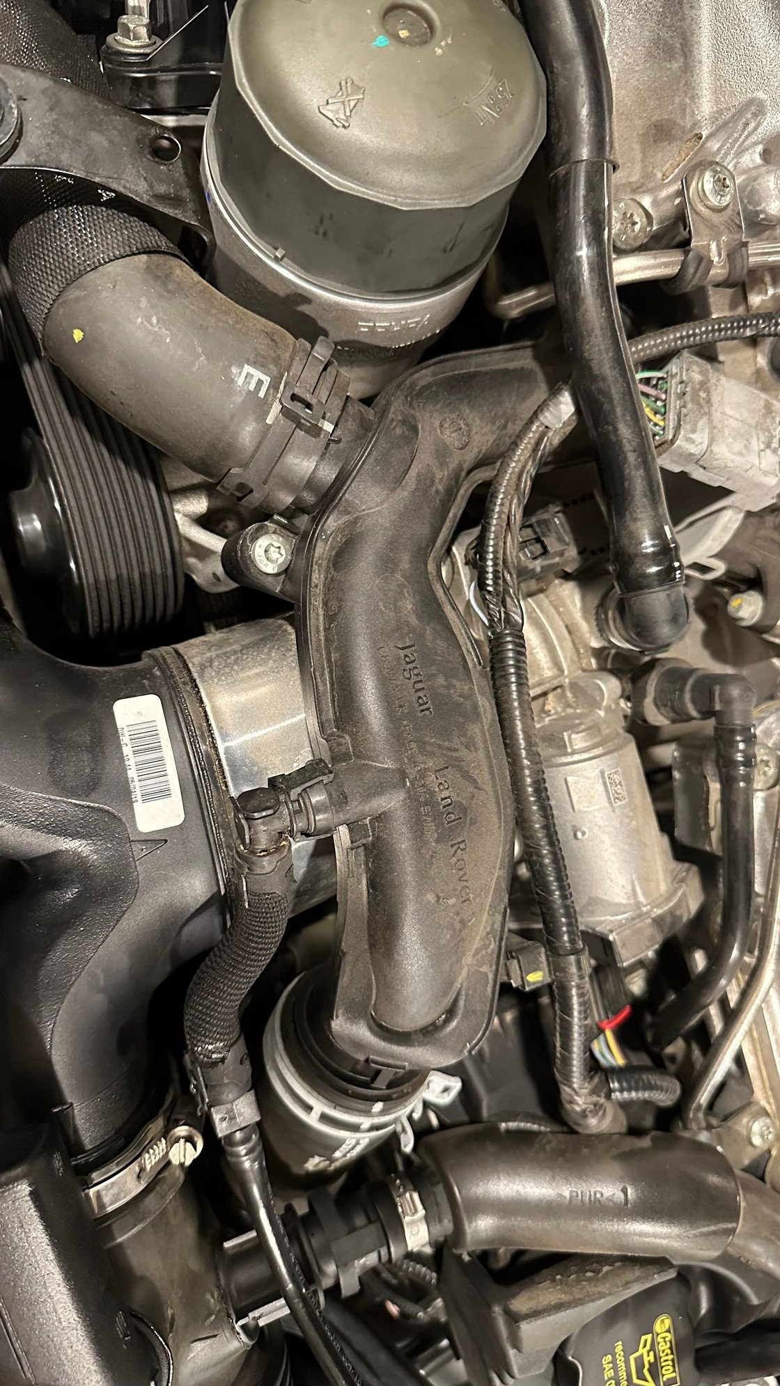

Here are the pipes in the final edition of the XJL, made in mid 2020.

And that top crossover pipe shown in your pics is definitely the crappy seamed one, I had no idea JLR continued to fit them on later models right up to 2019.
Oh... crap...
Old Oct 14, 2023 | 11:37 PM
