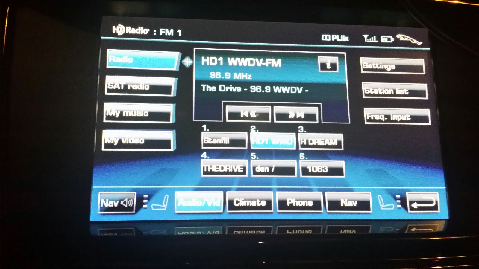

This is what I have. I wonder if there was a model year break? Mine was mfg 11/11. I figure there HAS to be service menus in there somewhere.

Enosgl, if your valet button is in the lower right, then well, press and hold that down like I mention above. That should get you into the service menus and allow you to make the changes to the bass.

Thanks for the suggestion, but that was the first thing I tried. Then I tried holning in the upper left of the screen (where it says "HD Radio"). I also tried weird combos of holding valet and pressing other buttons.

Enosgl, here is a sample of what you can find.
Maybe this will give you an idea or two on what to try. I wonder if you may need to change the view of the screen to get the valet button to show up. I seem to remember on mine that I have the option of a few different layouts. I guess I need to go out and look again. I found the one that I liked and left it at that.

Long pressing the Valet button on mine (lower right) does nothing. I held it pressed for maybe 30 seconds.
