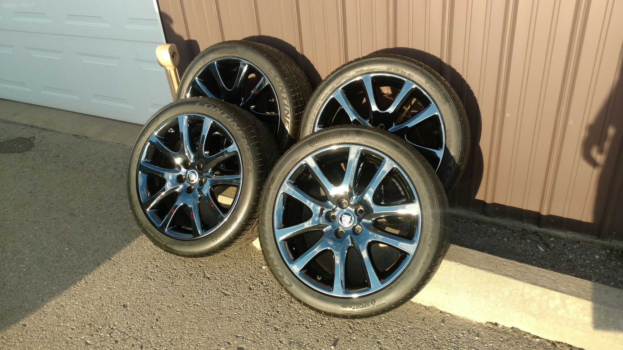

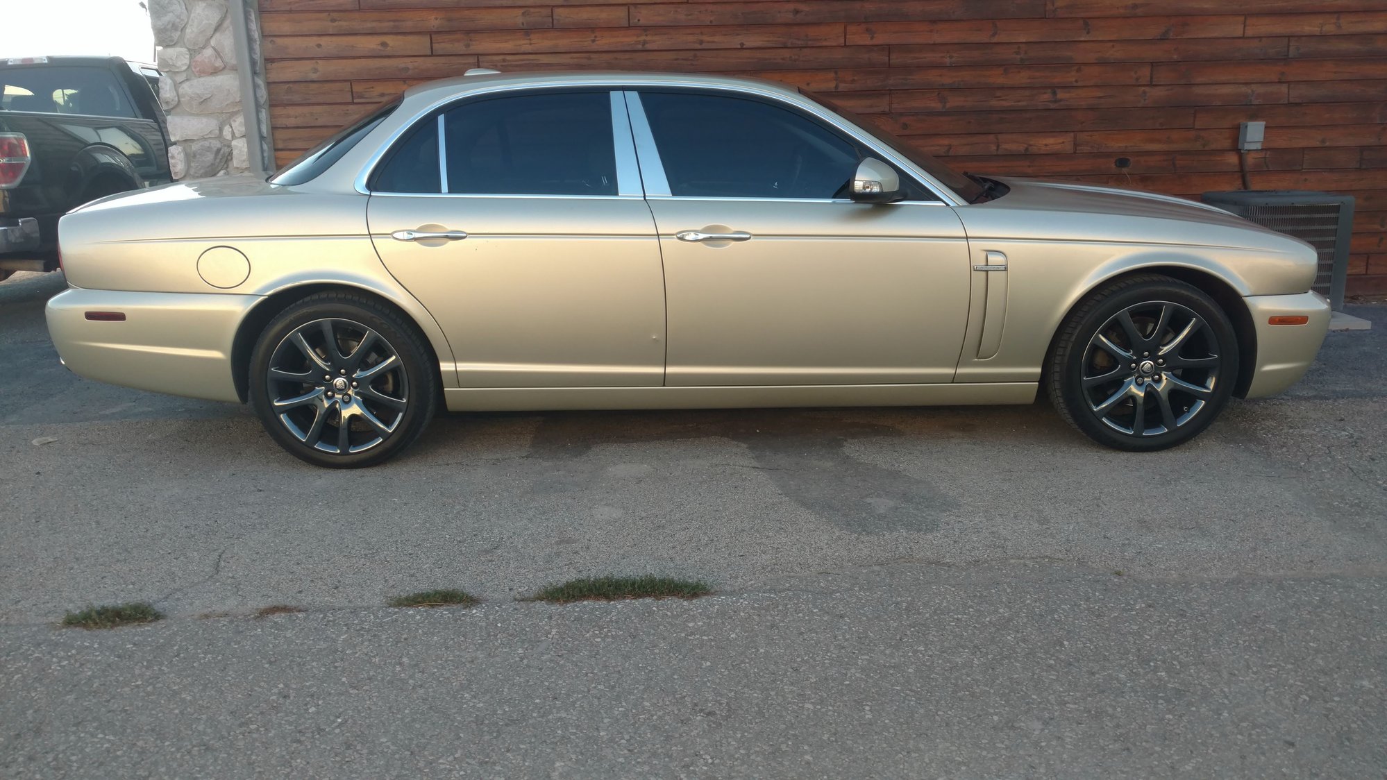

Just put my refinished v style 19s on my 2008 xj in winter gold. I went with black chrome pvd. I also added 5mm wheel spacers to fill the wheel well. I needed one tpms to hopefully remove tire pressure monitor system fault from the time I purchased. I got a unit from Napa that was the correct frequency the lights went off for ten minutes and came back on. Jag dealer says they have to be Jaguar sensors or won't work. Please help me. Thank you from northern Michigan.
