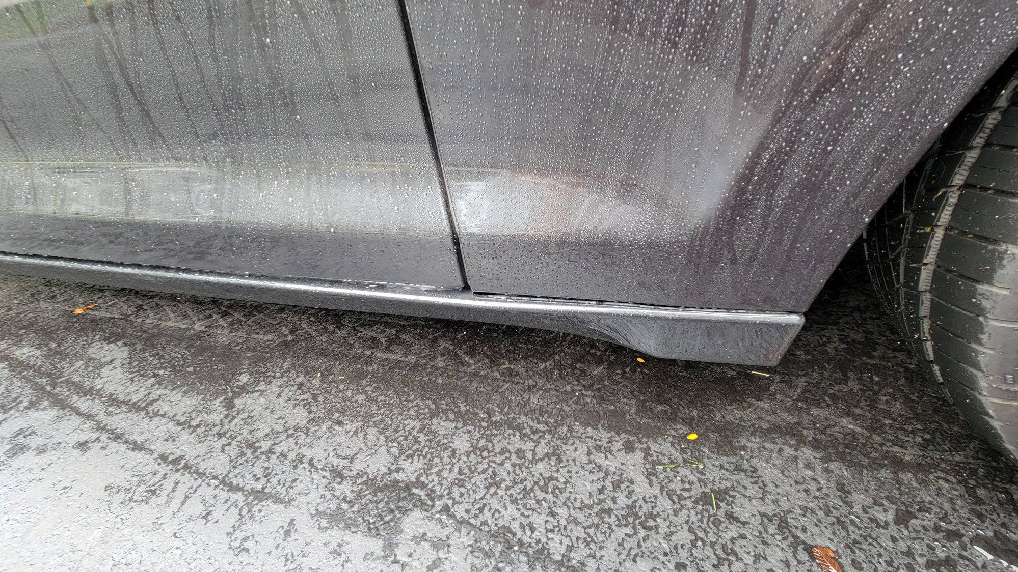

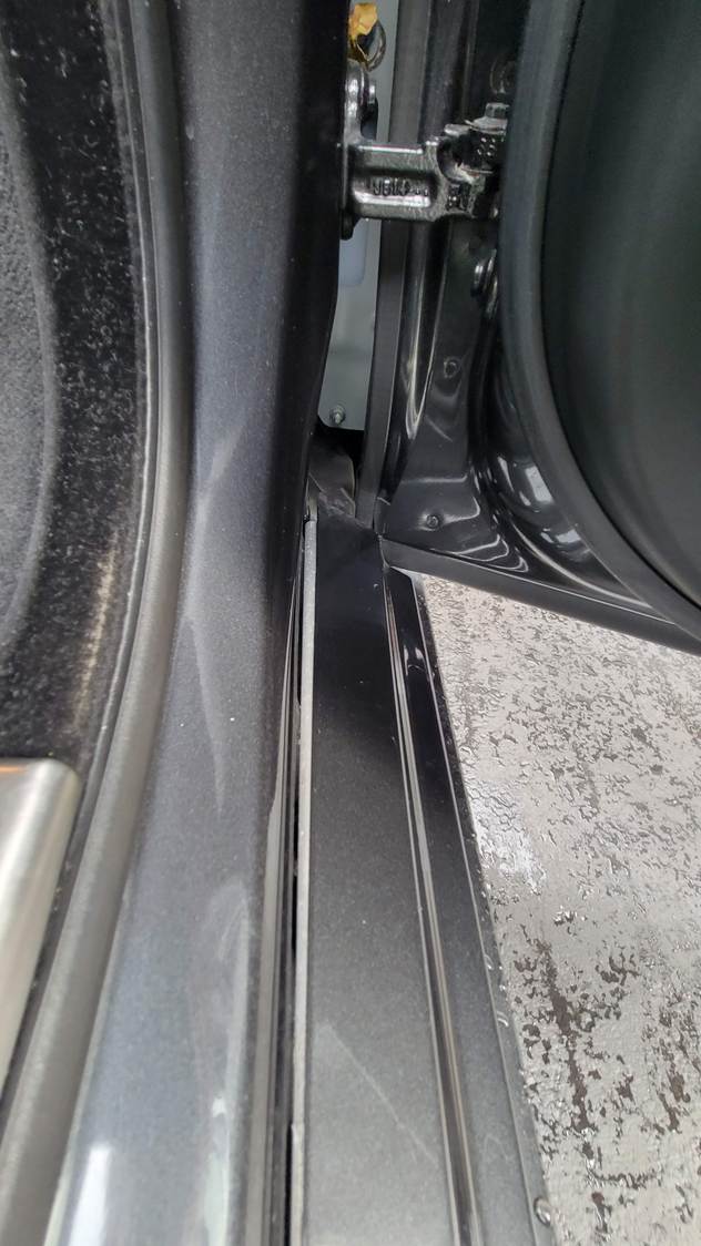

Hello...I was at the tire store today and they must have jacked up the car incorrectly and cracked several of the clips that hold on the side rocker trim. Anyone know what the P/N for these clip is? How easy is it to replace?
Sorry for the dirty car!
Thanks for you help!
TJ

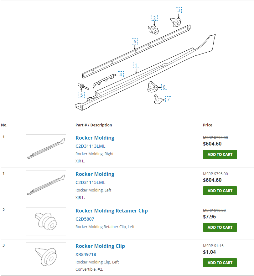

C2D5807
A box of 15 for the price of two from Jaguar.
https://www.clipsandfasteners.com/Ja...7-p/a22157.htm
The yellow ones (#2) always break when you remove the rocker. Normally the white ones (#3) on the ends are re-usable.
