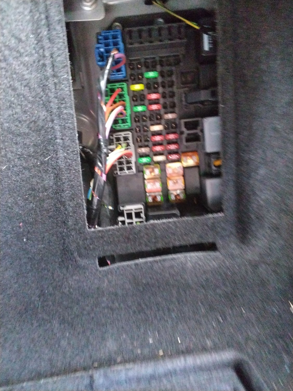

Default Can someone draw an arrow to where the fusible link is? AI gave me a weird blotch.

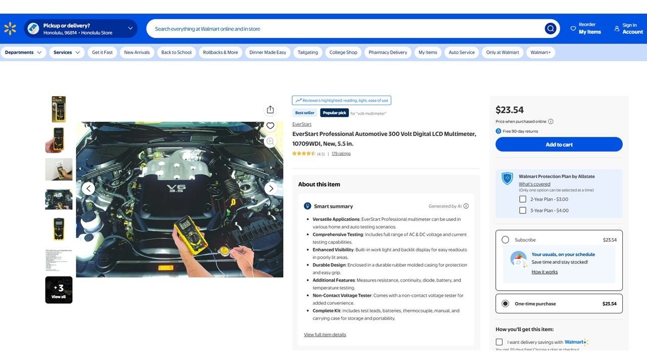

This one is in stock at the Walmart in Honolulu. You can use it for all sorts of things around the house too.

Didn't know they were that cheap, thanks.
