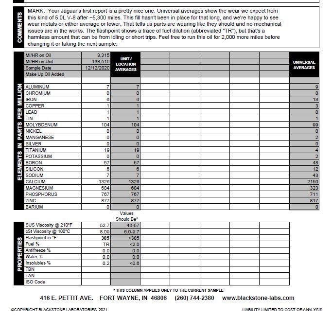

I did send oil samples in to Blackstone Laboratories within the last couple months, and thankfully the Jags analysis was reassuring.
