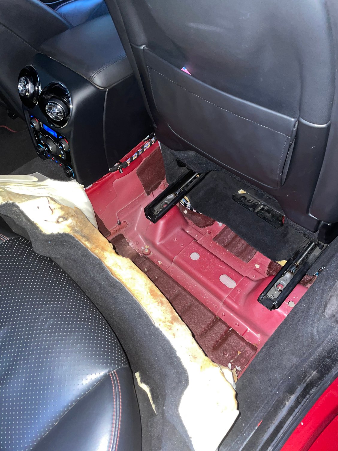

rear footwell on the driver side is soaked with water,
seals on the doors seem fine,
I did catch the boot release button months ago and the boot got rained in,I dryed all that out and it’s still dry.
Wonder if there’s any chance that could of found it’s way forward and it been sat like that awhile?
I hadn’t noticed with the kids seat being on that side.

The bottom seat cushion in the rear is fairly easy to remove. Like most cars, you push the cushion rearward, then lift up. Maybe you'll see moisture evidence and a trail from the trunk area.
Another possibility is clogged drains of the sunroof.

Thanks Iv pulled the rear carpets back and squeezed most the water out,
the footwell does appear closed off from the boot I’ll check the sunroof drains.it’s a funny one never had this problem before.
be worried about mould forming will have to keep an eye on it.

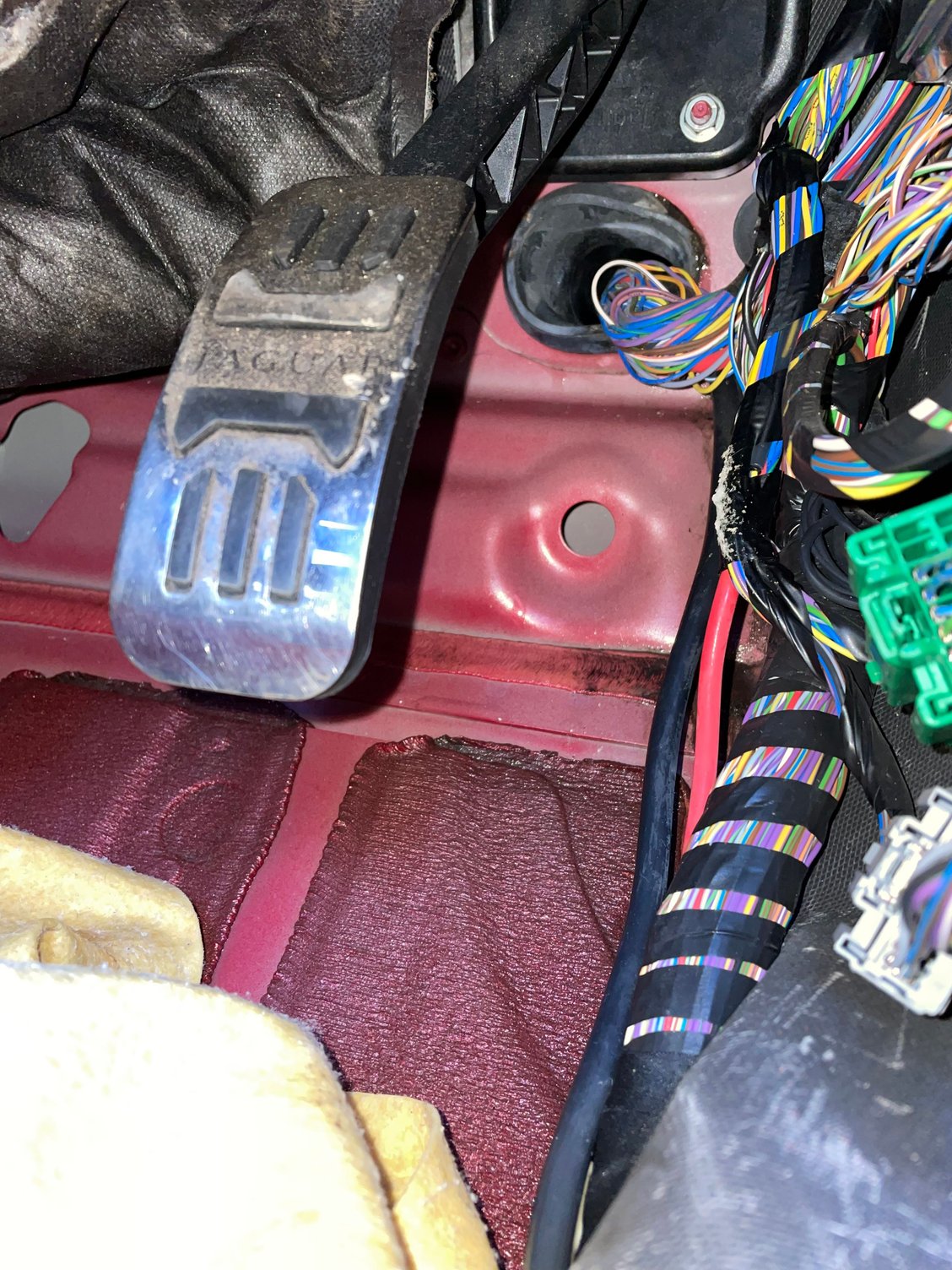

So I found the leak it’s coming in through the drivers side front were the wires come through,it looks like the rubber gasket has been put back badly as a result damaged it.
Iv used a black silicone from Halfords to see if this stops it.as I dry out the carpet and foam..
