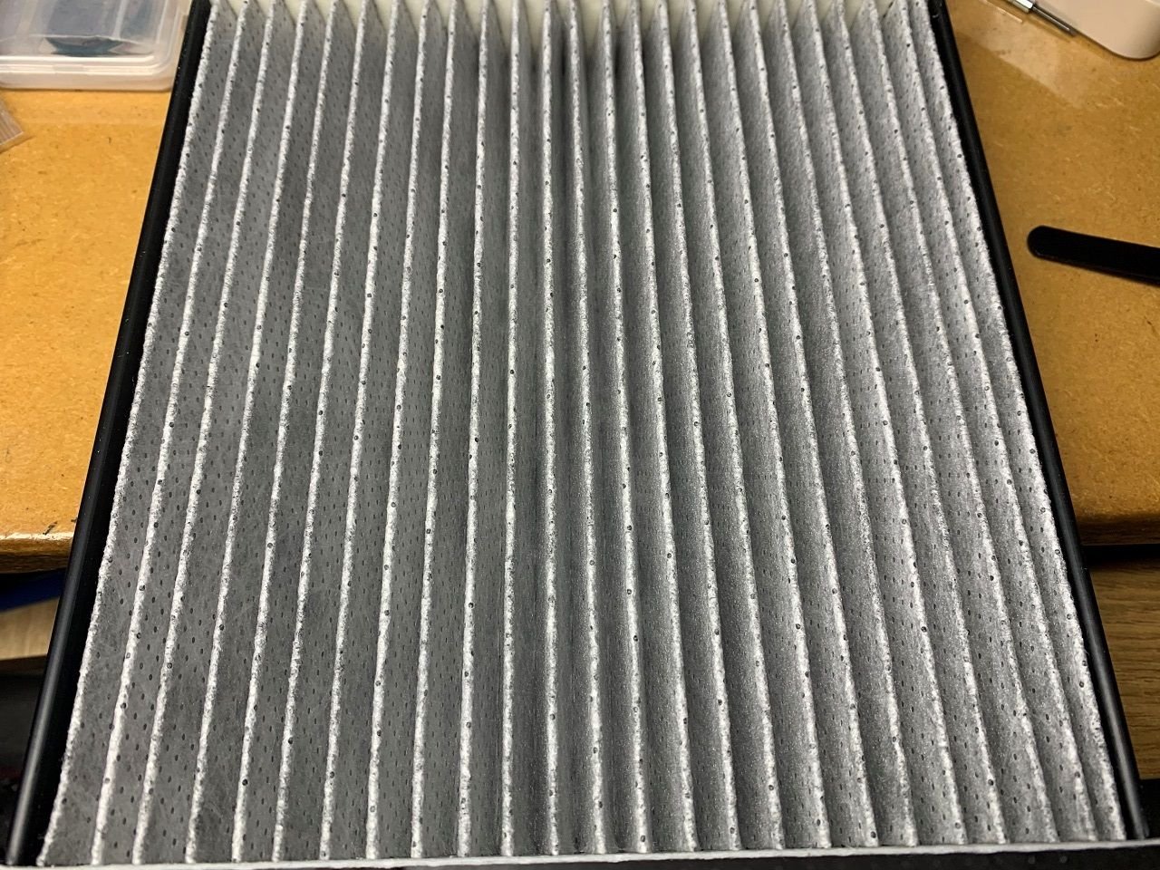

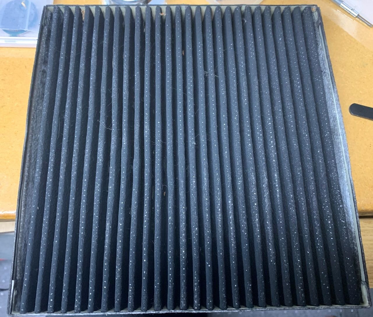

I have a 2010 XJ with a full service history, the book is stamped and all main dealer ....
And it isn't worth a turd - no way has this car been maintained to a standard I expect of Jaguar - Jaguar is fortunate I don't know the full history of what the previous owner permitted or didn't. The car is also saying the last oil change was 14,000 miles ago ... neglect of the worst kind.
This is an example - these images are of the cabin filter - one is new and one came from a 'full service history' car. Do yourselves a favour and stop putting any faith in service histories or dealers to do an adequate job - if this is what £200 an hour buys you I'll stick to DIY.

I like to use the activated carbon cabin filters. I little more money but I think a better product too.
Yes the cabin filters are an often forgotten item. Even worse is I have found cars with factory installed cabin filters even though the service records show it being changed multiple times. Usually you can find a printed date and brand somewhere on the filter.

That's exactly what I've installed. The brand of the filter was Jaguar - can't recall anything else and it is now in the trash - I 'may' go look but then again ....
One of the reasons I went exploring was because the air delivery was appalling but fine on recirc, it is amazing the difference this filter makes, I had planned to change it anyhow though hence my having one to hand, I installed a Mahle activated carbon.
