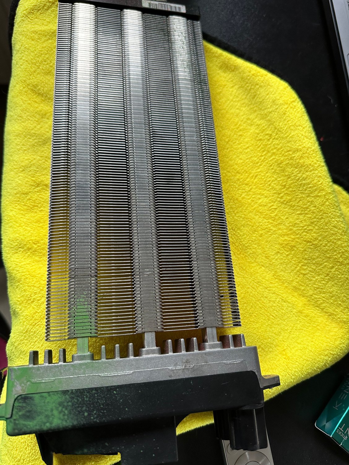

Just got one…. Brand new second hand one, like mat Armstrong says, British youtube.
I opened it, Bord seems ok, no black brown areas or connectors. It was sealed by the sticker in the pic. Never opened.
Just one question for you guys who did this……
You changed the whole piece, with the radiator or only the electronic board?
How tricky was to get it out?
Thx in advance for the info

No answer but thank you for the picture as I have never seen this large electric heater before because it's only installed on Diesels.
Learn something new everyday on this forum!
If needed can take pics with measurement

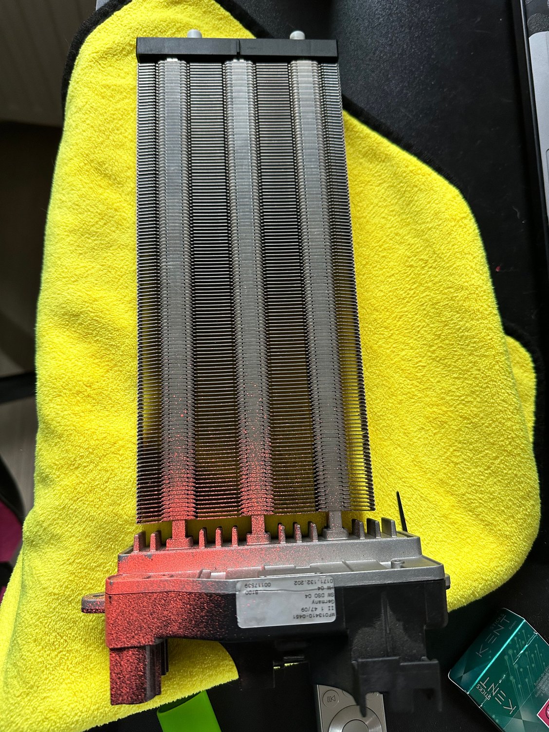

Can someone help me?
After the sound 🤣succes with changing the cluster fan(will post pics soon), I want to do the next in the dash job at home myself( cheap ******* I know🤣&#129315
So…. Heard that you only have to change the electronic board. O got the screws out and…. Won't move! Tryed to move it slightly with a screw driver, seems glued with that grey paste you se coming out from under it!
1….. How to un glue it? Heat? Constant pressure?
2….. Probably same with the one on the car?
3……one of the connectors is thru the boar, thru a metal sleave! How to approach that?
I know I have some pics from a thread somewhere….. But if someone knows where is the thread more precisely, you'd spare me of hours of searching g I line or on my photo screen archive!
Ps: seems like a really really tricky job. The good part….. Its left hand drive, no steering column to get out 🤣🤣🤣🤣🤣

Yes, its is bit tricky and dangerous for your spine by working position.
Check that you removed 4 torx screws holding PCB.
The PCB have push fit commectors for resistors generating heat. These come out only straight upwards. Also Plus input voltage pole have tight fit with its insulator
I added forces side by side with wide plastic pray tool from each sides until everything gave up and PCB just dropped out.
Some WD40 can soften the heat paste a bit.

sure…. In the donor board…… but in the car, in that right Space, what did you use to pry the pcb out? Plastic levers or metal-screwdrivers?

And….. Did you use a heat gun? Or only mechanical force?

I used plastic pray tool mention for used exsample interior parts, door liners, etc. It have an bend end so i got the tool under pcb.
Heat gun do not help. Heat have cooket the thearmal paste for hard compound now securing pcb in place.
Note: You have new working one... ... No mercy moment?
