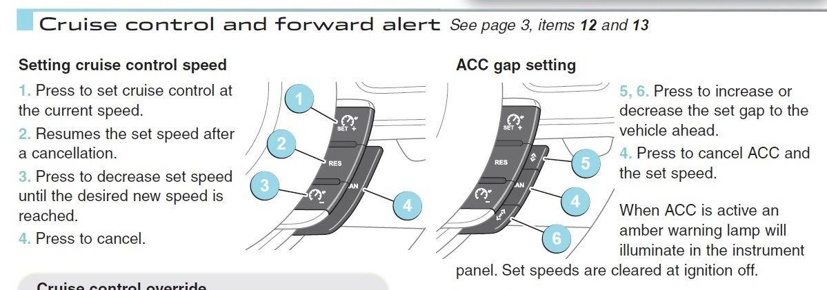

It was available on x351 on launch date 2009. The radar was behind the front grille, not integrated on the grille like later models. You can see if it´s there by steering wheel control buttons of cruise control part. Non-ACC 2nd row have only Cancel, where ACC models have 3 buttons for + and - distance and Cancel. You can find this from 2010-11 handbook /quick start guide if you want to be sure. (sticky section)

We have ACC in our '16 Portfolio so I knew about the buttons. Thing is, almost every picture of the wheel in online ads fails to clearly show the second row of buttons and most ads do say the car has ACC. The few ads that you can clearly see the buttons (and also do say it has ACC) show non-ACC buttons. Basically, the only way to tell for sure is if there's a clear shot of the buttons (there usually isn't), or if there's a clear shot of the grill (always is). Additionally, the few that I have called to inquire about ACC have told me it does have it, then the requested picture of the wheel they send shows it doesn't. It's a real pain in the ***, and that's why I was asking about the brick. It's really easy to tell externally on the '16+ models, but I guess on the <'15's I'll have to ask for pictures every time I'm interested in what's listed.
I did find a thread that indicated adding ACC to a '16+ non-ACC car is just a matter of adding the buttons to the wheel and the brick/grill. I'll have to read a bit more about that to verify what I read was true but if it is, that does open up a lot of possibilities. I've already looked up the cost of those parts and they're within the range of what I'd consider money well spent if they're going in to the right non-ACC car.
Thanks for the replies; I feel my questions have been properly answered.
