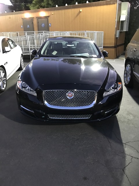

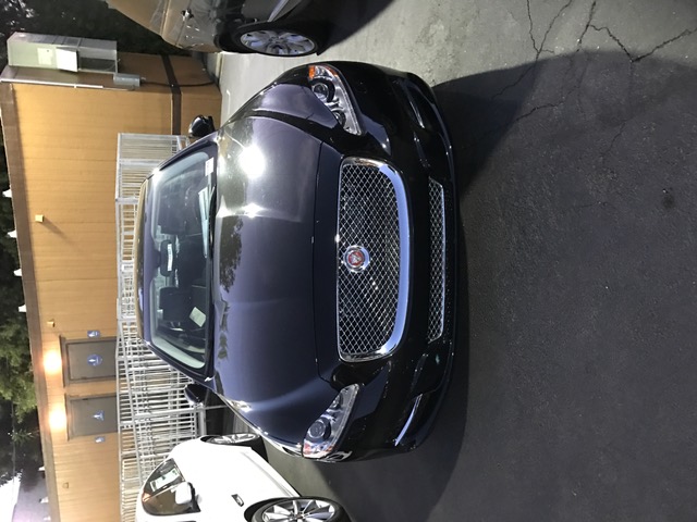

Where are the pictures lol?

Here ya go.
Attached Thumbnails I found my car, need some advice-img_1657.jpg   I found my car, need some advice-img_1656.jpg   I found my car, need some advice-img_1655.jpg   I found my car, need some advice-img_1661.jpg

Sorry, little easier to see.
Attached Thumbnails I found my car, need some advice-img_1657.jpg   I found my car, need some advice-img_1656.jpg   I found my car, need some advice-img_1655.jpg   I found my car, need some advice-img_1653.jpg   I found my car, need some advice-img_1661.jpg
