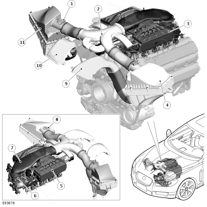

Dude... that diagram shows exactly what Avos and I are trying to tell you. I don't know why you'd use the icon. The diagram shows two intakes with two air filters and two MAFs.
Here's what the TSB that YOU posted says: "This may be due to variation in the air filter element material causing an imbalance in the intake air flow." and "Air cleaner elements must be replaced as a 'matched' pair."
Apparently the programming in the ECU can't deal with an imbalance between the two MAFs. It has nothing to do with fluid dynamics or turbulence or anything else. It's just the ECU injecting the wrong amount of fuel because it isn't programmed to handle MAF inputs that aren't similar.

Look, we're all friends here, we all want the same thing, to better understand and enjoy our Jaguars. Let's take a breath.
I just haven't yet been able to adequately get my point across. Maybe this illustration will convey more. All of the SC engines have the same intake setup, no matter whether there are two air boxes or one. All the air comes together and does not split to bank one or bank two until it enters the charge air coolers. I contend that as long as the incoming air is measured correctly, it should not matter if one side saw a little more than the other, it all goes the same place, the total air is what the ECM needs. I feel that for an imbalance to cause problems, it must be upsetting the air measurement by one MAF sensor.
With that, everyone, whatever filter you use, please enjoy your Jaguars to the fullest! There ain't nothin' like 'em!!

Originally Posted by xjrguy
All of the SC engines have the same intake setup, no matter whether there are two air boxes or one. [B]All the air comes together and does not split to bank one or bank two until it enters the charge air coolers.
That is incorrect. If there are two air boxes one box is considered bank one and the other is considered bank 2. Look at this from the TSB you posted:
Jaguar considers one air box as bank one and the other bank two. Each bank has its own MAF sensor.
I completely agree with you there. I would guess that Jag techs and the engineers who designed the system would agree with you, too. However the ECU isn't capable of adding up the air flow from the two MAFs. It gets confused when the two sensors don't match. That's why the TSB says that the air filters should be replaced as a pair. As long as the filters are replaced as a pair, the ECU won't get confused.
I disagree. Both MAF sensors are reporting the correct flow, but if there is a difference in the airflow between one bank (airbox) and the other, then the ECU doesn't know how much fuel to inject. That causes the engine to run rough.
I understand what you're saying, and I even understand the physics behind it, but I don't think that's what the TSB is saying. I work in the fire alarm industry and most air handling units have smoke detectors in the ductwork. The smoke detectors have to be installed in areas where there is no turbulence in the airflow through the ductwork. In other words, they can't be near any bends, tees, vents, dampers, or anything else that causes the air to tumble within the duct. If the air is turbulent, the smoke detector won't work properly. For the duct smoke detector to operate properly, it has to be a minimum of 6 duct widths downstream of any bends, obstructions, etc. That allows the air to assume a more laminar flow before entering the smoke detector. You're saying that the MAF sensor is similar to the smoke detector and it requires [somewhat] laminar airflow to work properly. That may be the case, and if it is, I'm sure the engineers designed the system so that the MAF sensor was located somewhere where it could accurately measure the airflow. If the air filter was going to affect the accuracy of the MAF sensor, then they would have located the air filter somewhere else. If anything, the K&N filter would be less disruptive to the airflow than a paper filter. It doesn't have all of the folds that cause different amounts of airflow from different points on the filter. The air can flow smoothly through the K&N whereas it cannot do that through a paper filter.
We agree again!
