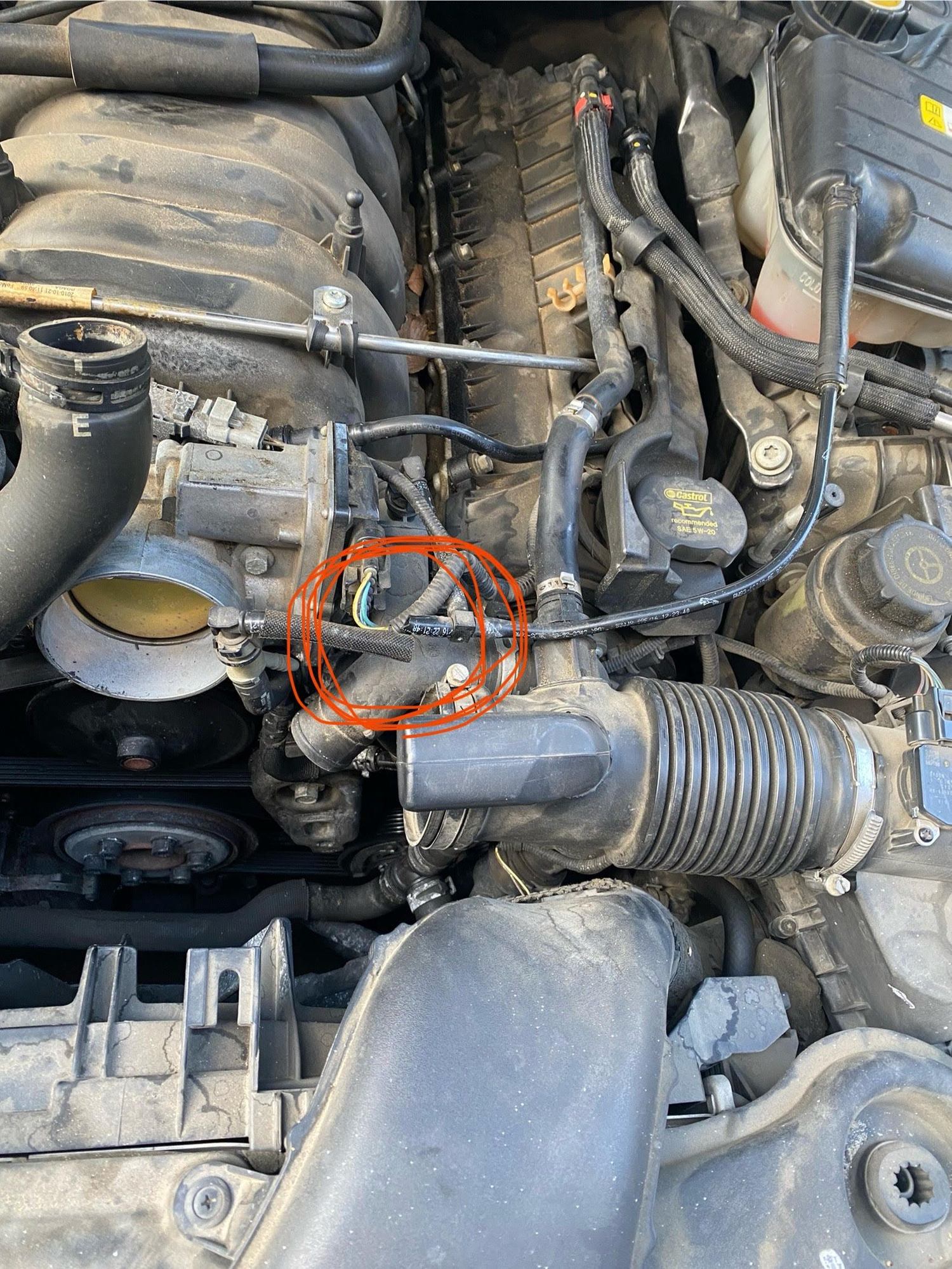

I am replacing the waterpump on my 5.0 naturally aspirated, I gently pressed on this line to get a better view and it snapped. I am looking for a parts number to replace it.

Cooling vent hose. C2D6362
Be sure to check fitment. I am sure it's the same across all/most but didn't check into it that far. Came ac oss an aftermarket on eBay for like $23.

C2D6362 is for the Supercharged car.
C2D6005 is for Naturally Aspirated.

Odd when I checked compatibility for a 2011 XJ L 5.0 naturally aspirated, the C2D6005 part came back as incompatible on the website.
