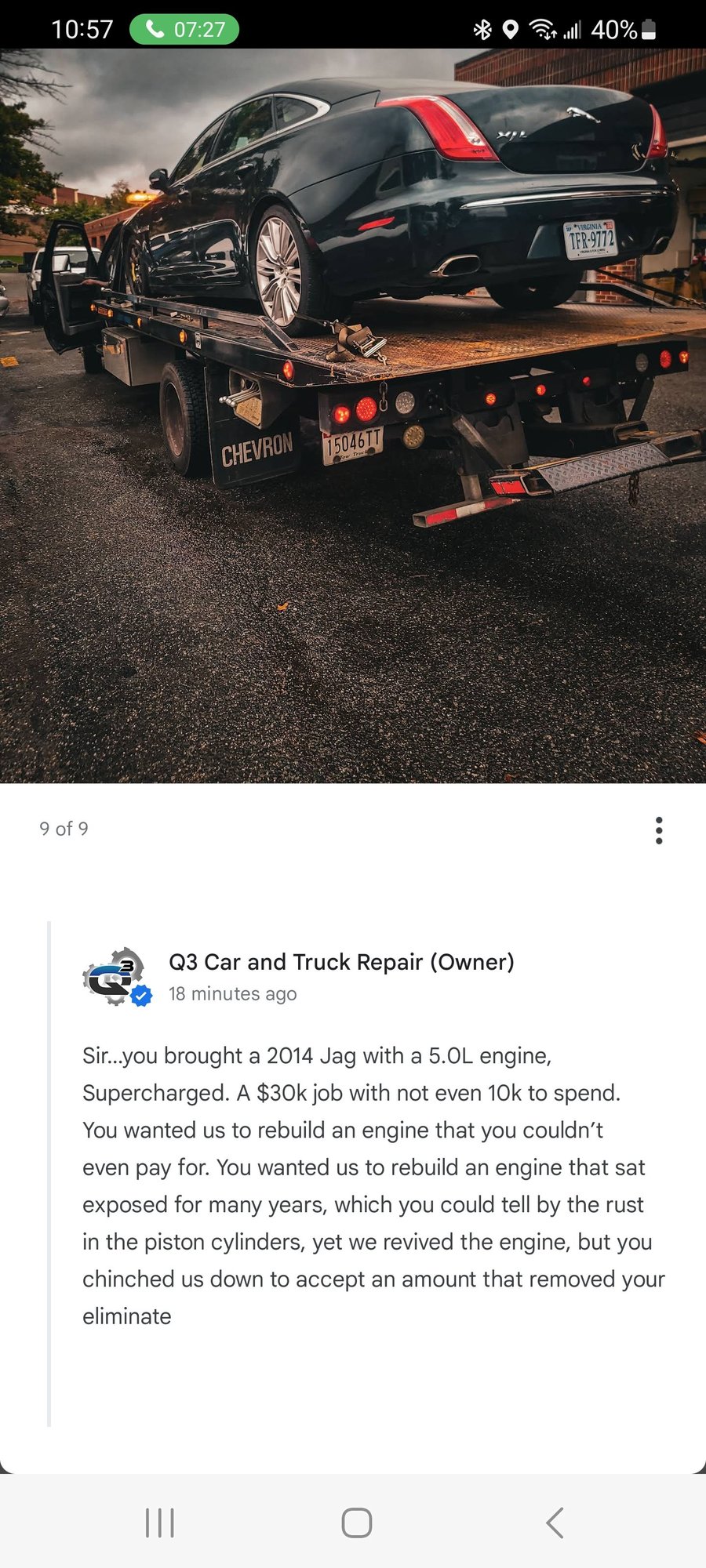

If I find that during my engine testing that there's anything that requires me dismantling the engine to fix what they neglected I'll go that route.
I woke up this morning and saw he updated his response. He fabricated throughout out his response, saying engine rebuild for this specific engine is 30k, that my car is 2014 (it's 2012), and that I had the engine completely rusted out for years. When it ran before it got to the shop. And he was the one that had it sitting for a month with water in it after attempting to start it
Also in his message he stated they are only doing tweaks and diagnostics for the engine. Not anything that requires parts as part of special warranty that has no liability, so in my opinion they had no intention of addressing that misfire and I'm better off doing it myself so at least Im comfortable knowing nothing else unfortunate would happen.
Like getting more of my stuff stolen and or faults created in different areas.
This first response
His second response after he edited it.
I had no intention of bringing it back anyways. I guess I'm just the crazy guy to the area who paid 10.7k for a misfiring engine and still got called cheap by them. After they put me through the ringer. It's okay life goes on and I'll address the issue as I should have done in the first place
