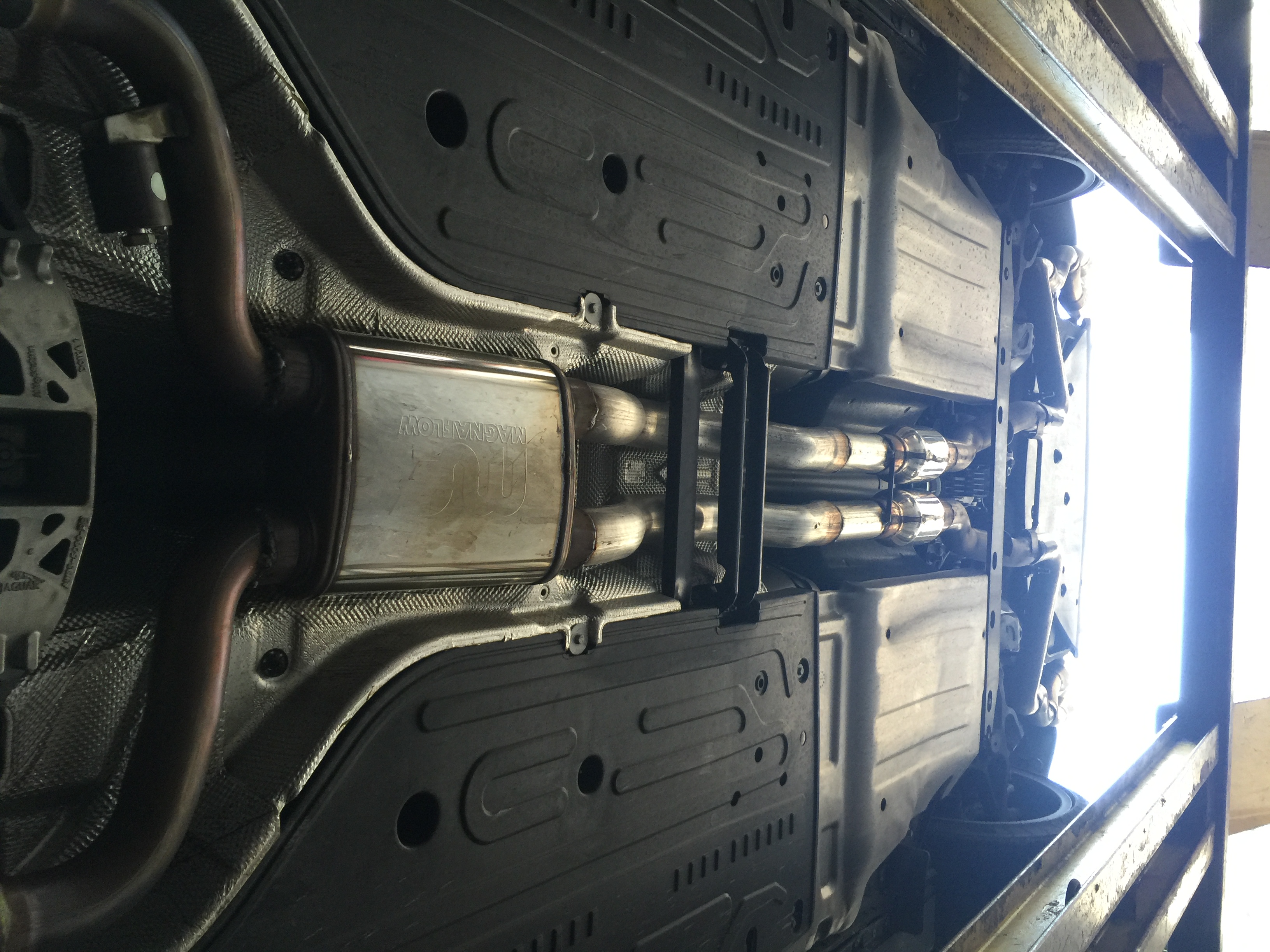

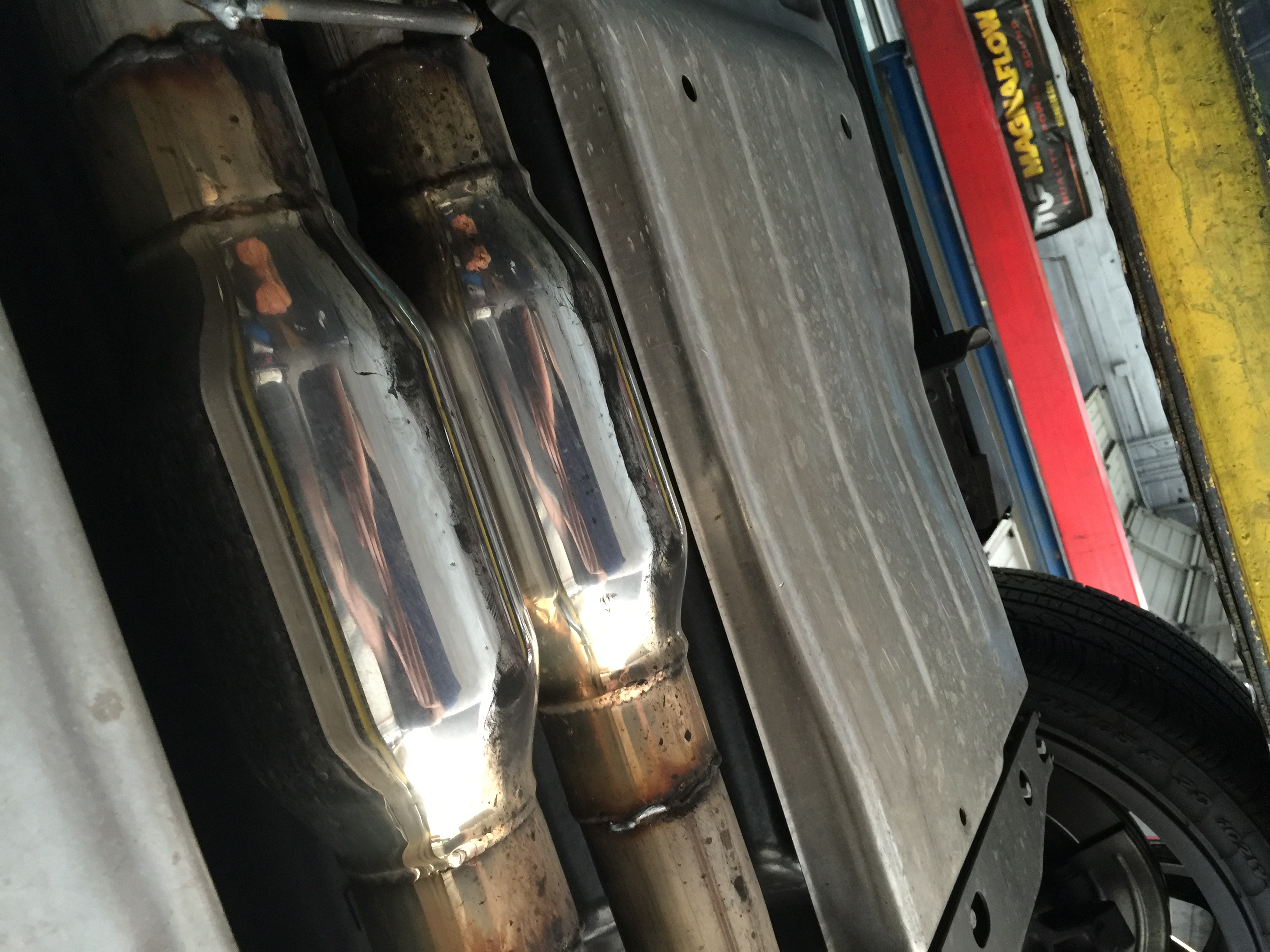

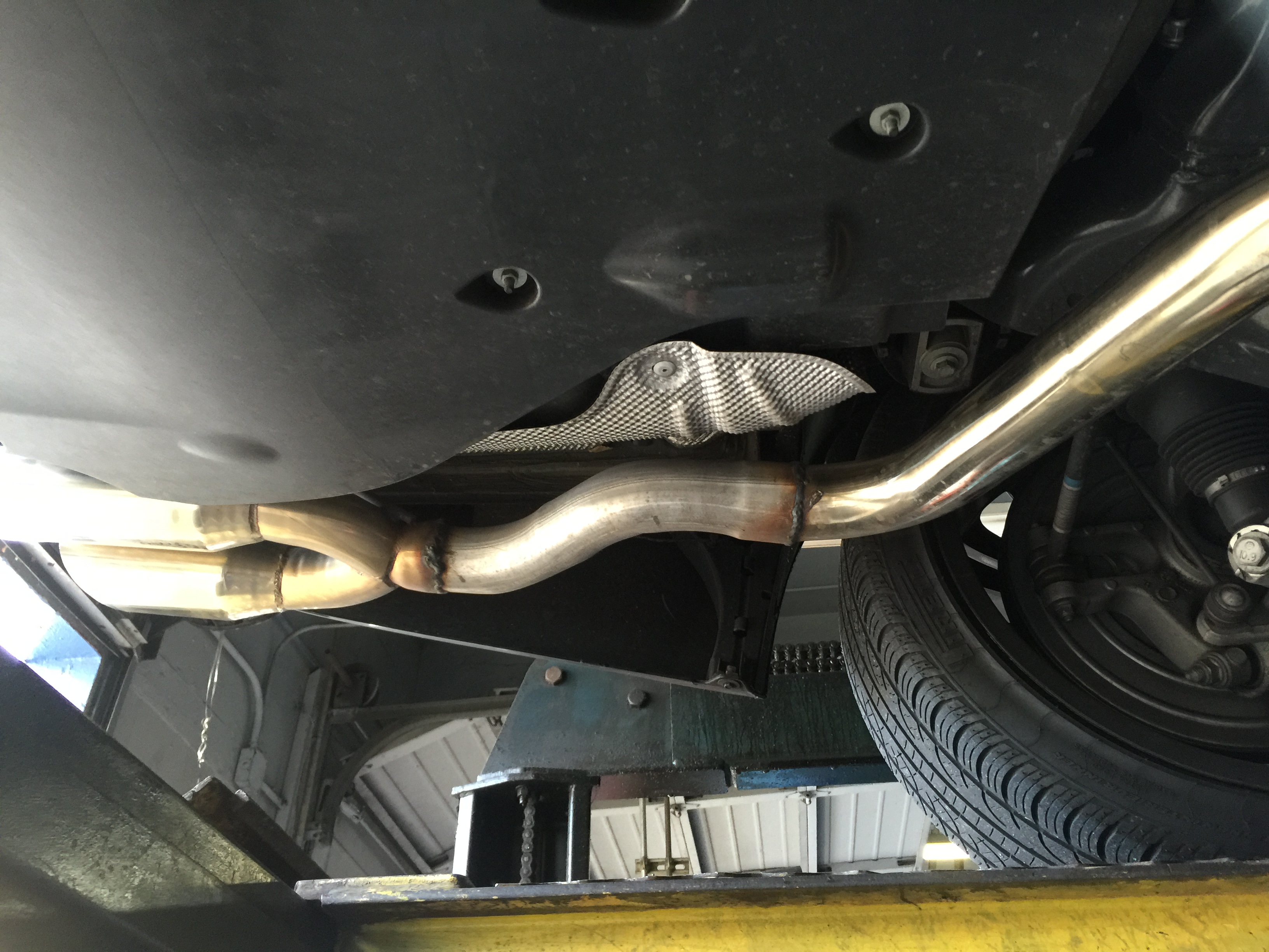

Here are the pictures I promised.
Attached Thumbnails My XJ Sounds Like An F-Type Now!-img_0662.jpg   My XJ Sounds Like An F-Type Now!-img_0664.jpg   My XJ Sounds Like An F-Type Now!-img_0663.jpg
