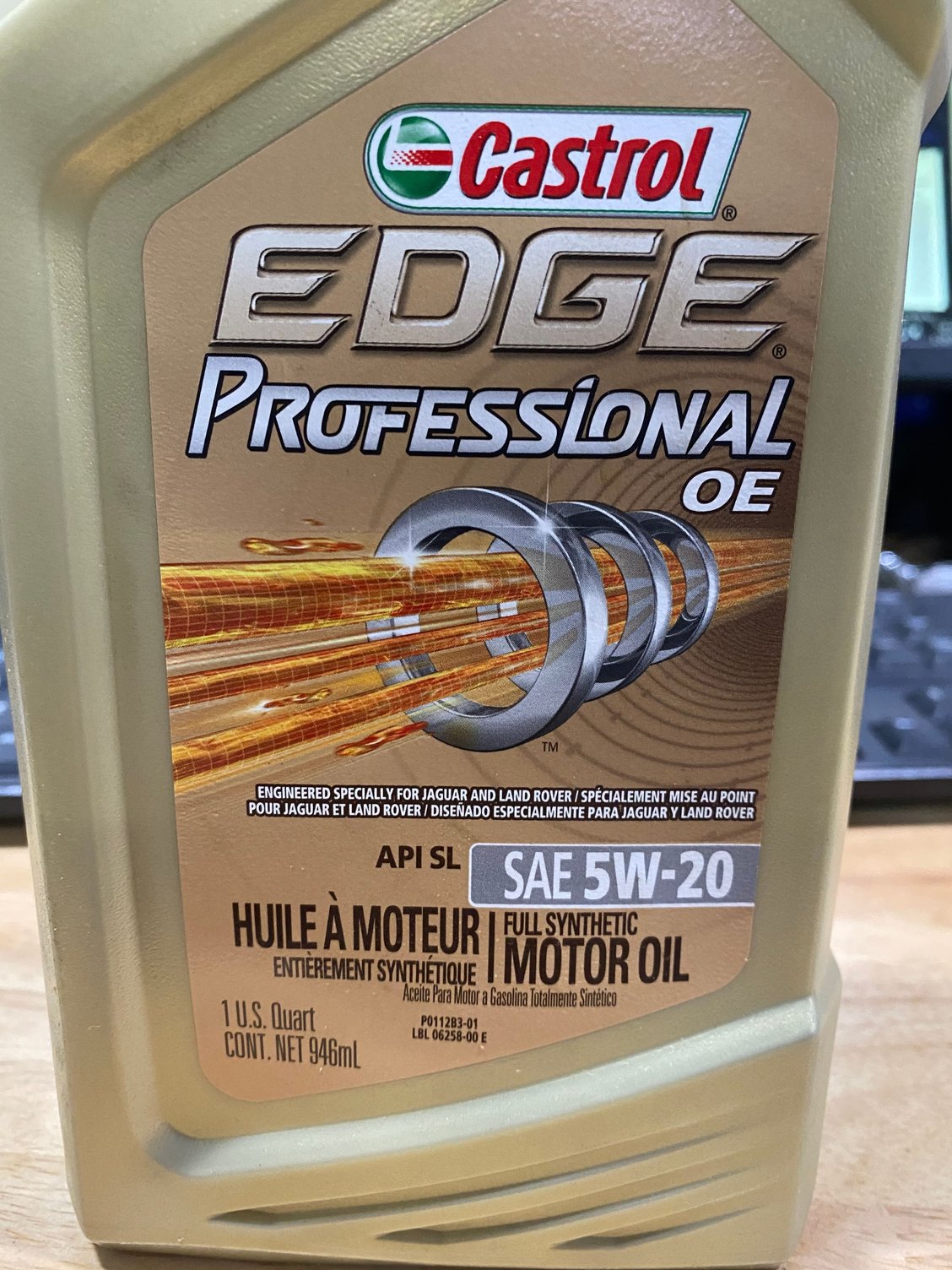

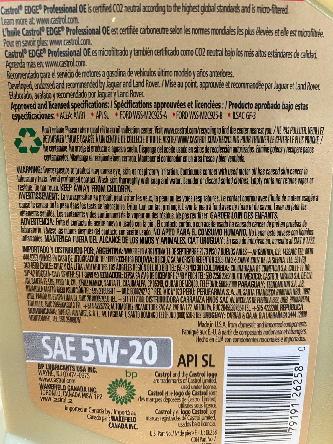

The dealer uses this and haven't seen anything about super session of numbers.
