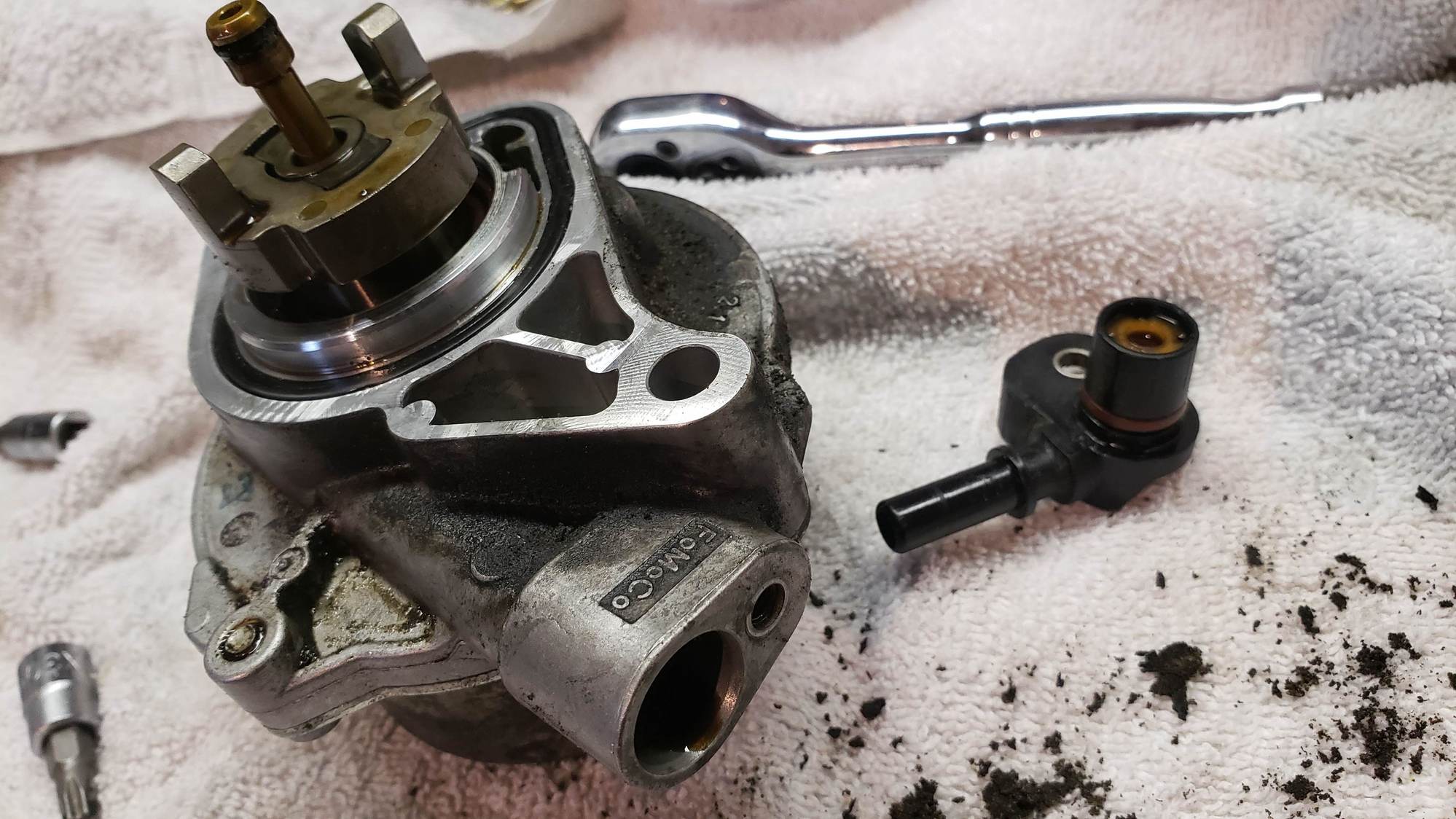

Just to follow up this is now fixed! There was a small o-ring in the black vacuum connector that goes to the pump as seen on the right. This is where the oil was oozing from. I replaced it with a #7 o-ring 1/2" OD x 3/8" ID. You don't need to remove the pump for this, but it you do also get a Jaguar gasket ring #C2D3771 for the pump to block interface as seen on the left. I pumped all the engine oil out and then pumped it back in when finished and there was no spillage.
I miss my warranty.

Thanks for reporting back as I have not seen that small O-ring leak before but your picture did indicate that was the problem.
