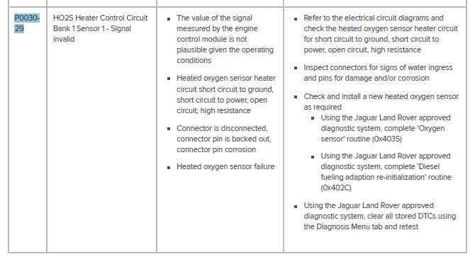

Question (P0030) Heated oxygen sensor Bank 1 Sensor 1 location & part #
Hi all,
It's been a while since my last post.
I've been getting an EML lately either due to NOx sensor or oxygen sensor DTCs.
Where are they located? The car has 67k now, so I might as well replace both. The oxygen sensor 1 is on the exhaust manifold? Where exactly, which side? The NOx sensor is somewhere at the bottom?
The P0030-29 code came up today. I don't remember the code for NOx but the description was something similar to the oxygen sensor code.
Where can I find a part number for those two sensors?
I'd really appreciate your help, guys!

It looks like the cat needs to be removed to gain access...
Parts needed:
C2D49904 Catalytic converter to Diesel Particulate Filter (DPF) clamp
C2D50934 Left exhaust downpipe gasket
C2Z15576 Right exhaust downpipe gasket
C2D28705 Sensor (FX23-9D375-AA)

Thanks for that info and the diagrams!

I took it to a local Jag indi and they had it done within an hour. They even washed my car, lol. All back to normal 👍🏼
It was the heating element, and when tested with a multimeter, no resistance value showed.
