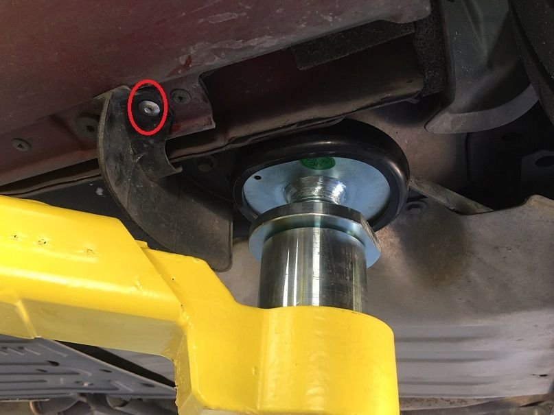

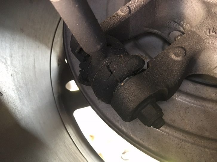

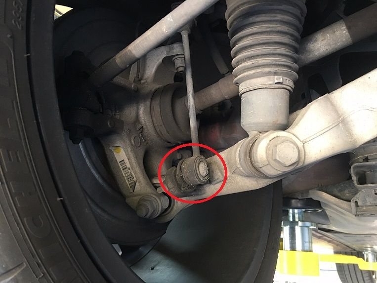

I finally got another 2 post lift and decided to change the rear diff fluid as I am at 62K miles. Only have 20K miles on the fluid and it looked better than the first time. Still black but with a hint of golden color. Used the same Redline fluid as before.
But I found some worn suspension parts and will be replacing the rear sway bar end links. No grease zerks either so no way to grease them. I went with the Lemforder brand. Not from Jaguar but hopefully a good quality part.
Also the rear Toe links were done as well. Both of these are common wear parts so not unexpected after 10+ years and 62K miles.
Found an odd thing with these small plastic wind deflectors? For some reason 1 out of the 3 rivets holding them on was tore out on both side? No damage to the deflector and a few rivets later it was fixed.
Sure like the new lift and it has some improvements too. The ends now dip down so it's lower to drive over. I also got the double adjustable screw jacks for each arm. This is an extra tall lift with 6' 3" under the arms. So no banging my head on this lift!

Good looking lift. Arm end supports looks solid. Always remember to check the weight balance when use 2-post lift.
The darkness on read differential oil comes from limited slip clutch plate particles. Its totally normal. They wear on use and because there are no filter all particles stay on oil. Diffs without LS the oil are normally bright even after 100k Miles (+150t km). I have an opinion for oils used on any friction clutch plate/plastic systems, after reduction of mineral components on lubrications and plastics about 2006-2010. After that (and few expensive lessons) i havent used any other than manufacturer recomended lubricants on any systems with plastic-/ teflon-/friction plate components.
The 60t miles are nothing for rear suspension joints itself, but age hit the rubber covers. I changed one toe link for same reason on mine at ~280k km (175k miles) and the joint itself was still tight, but rubber cover broken. Other side stll good. (i check them all twice a year during summer/winter tyre change)
As far as i know the Lemförder (part of ZF group) are OEM supplier for all x351 suspension components, exept shocks. (i quess the front and rear axles are delivered as complete by ZF for the assembly factory?)

Yes I found the same thing. The rubber boots all fall apart but no slack or noise in the joints. Plus these parts have not been changed in decades and believe it or not are exactly the same as my old 2003 Lincoln LS! Pretty much from 2000 on they are the same for the Lincoln LS, Jaguar S Type and XJ plus more. Very common parts.
