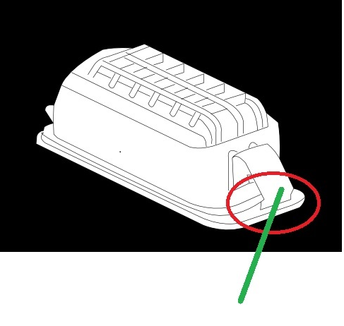

Ok. I need help. I got my order in, but a few things I need help, so please help me!!!!
1. The rear footwells seems to be 31 mm and not 36mm. I measured the bulb. In any case they sent me the wrong bulb so I need new 36 mm however I think its 31mm.
2. I cannot seem to get the license plate light to pop off, i think I may have damanged the bumper a bit. it seems to come with it... can someone please help me with how to on that? it doesn't look like it pops off...
3. The rear trunk light I took the original light off to measure again but it wouldn't go on anymore..maybe i blew a fuse?
4. Mirror bulbs, I cannot figure out how to get them out, same goes for rear interior lights. I don't want to damage anything so please help me
BTW the single CREE with cover bulb from superlumination is perfect for footwells just the right amount of white light.
Thanks in advance
Ram

Ok I figured out the rear interior lights. Still need help on how to remove
1. puddle lights
2. front interior lights
3. rear license plate lights (they seem to be not pryable at all)
4. Vanity mirror lights(two in the rear)
Can someone atleast give me some direction

To get at the license plate bulb you remove the lamp assembly by inserting a small screwdriver (the Green line in the drawing) and have to catch the tab (circled in red) and ease out the assembly by prying it out of the bumper, The tab is on the right side of the bulb assembly where there is a Small opening. Hope this explains it.

Thanks. I tried again today but maybe I jammed it already. I plan to take it to the dealer tomorrow to get some help.
I have done a ton of these though.. .. not sure what went wrong.

Ok. I took it to the dealer this morning and XJsss you are right it has a catch tab, which is tricky to remove. Finally got it all done including the front bulbs which seems to have four tabs.
