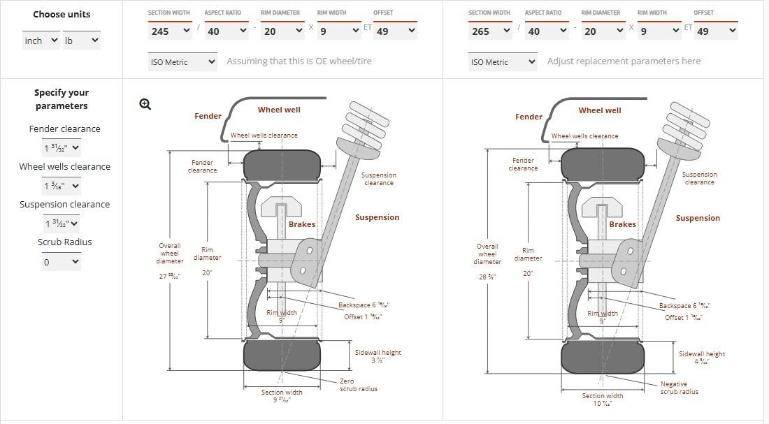

This are one of good tool to compare different tyresetups: https://tiresize.com/comparison/

Yes, With 18" wheel you will have much more better drive. (in fact pretty much only benefit for 20" is visual and of cource thats only matter who likes what) You will naturally need more sidewall for the tyre when you go for smaller wheel to keep overall rolling diameter same between 20" and 18".
With the tool on link you can add your OE 20" size and compare different width/height aspect rations on 18" wheels to find the size to have closest rews per mile. Also tyreshop are propably happy to help you to find correct size.
