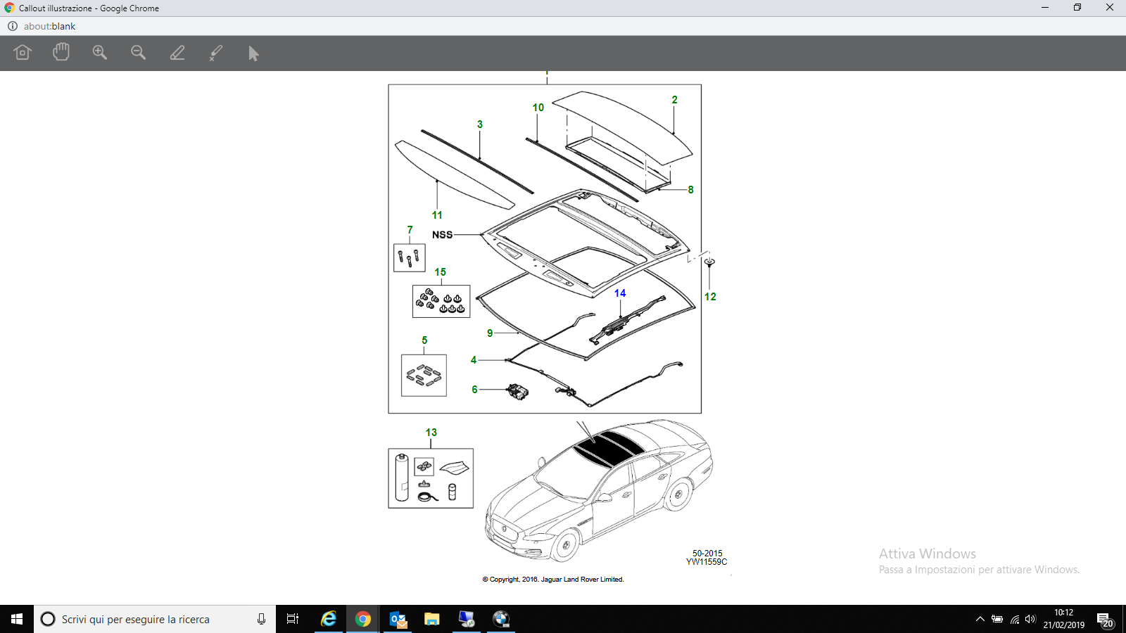

After a long time I finally found a guy that can do the repair of my front sunblind shade that doesn't move and make hard noise when activated.
Please can someone suggest me which parts should be changed? He will give me a previsional for the parts, I would like to know which parts are really needed and the parts that can do a perfect repair job.
Please help and indicate the numbers of the part that I have to replace!
Tnx you all.
SAndro

You need 14 and 15 in the first picture, Blind feet, and # 16 which is the motor/tramsmission. Since you have to remove the rear blind for the repair,
I would also recommend replacing the blind feet on the rear blind. Get two of #14 and two of # 15. It's a pain in the but to do.The blind feet are sided, so make sure you replace them with the correct one,
I lay them on the floor when I remove them so they don't get mixed up.
