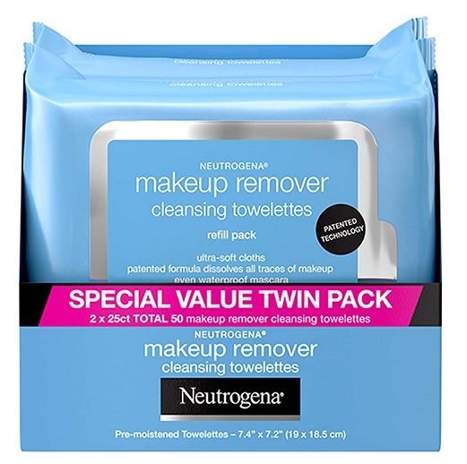

The sticky buttons have long ago been solved and it's a shame Jaguar has not accepted this and distributed the fix? Please read and use Neutrogena makeup remover wipes as they are the solution. Many threads about how to do this. Here is what the package looks like;
It's tedious to use them when removing the sticky stuff but it does work and I have all of mine cleaned up like new. Just takes some time. No damage to the buttons of any kind either.
Your dealership does not know of this fix?

Hey clubairth1,
You are correct! I was thinking of the XF! I just walked into the shop to look at a few cars and you're right!
I have tried so many different products on the buttons and am so happy you shared this with me! We aren't a dealership, we're a family owned Jaguar and Cadillac shop but I am a little upset the guys I talk with at our local dealership didn't tell me about this trick! I can't wait to try!!

Well we have only seen one XJ with a dash leather problem? Are you thinking of the XF? This does have a very large problem with dash leather pulling back.
... a shame Jaguar has not accepted this and distributed the fix? Please read and use Neutrogena makeup remover wipes as they are the solution. Many threads about how to do this. Here is what the package looks like;
Actually it WAS a very good dealership service advisor that told me about the Neutrogena pads years ago. If we look back it was posted it a few years ago (4 or 5?).
Sticky Buttons - Jaguar Forums - Jaguar Enthusiasts Forum
Maybe even before this post.
IIRC I also found that it worked easiest for me if I let a damp pad sit on the surface for a little while before rubbing off the stickiness.
A few spots did take a couple of times and a little more effort than others, but for the cost of a container of the cleansers, it was well worth it.
I still use the remaining wipes to clean those same buttons occasionally since they don't damage the finish or print, and it's usually my wife's make-up that's on them.

That's a good point on letting the wipes sit before you start scraping. I just had trouble keeping the wipes in place so they could soak in.
The tiny cracks between the buttons were the worst as the gap is so small I had trouble finding anything that would fit. I have some 2mm-3mm cleaners that sorta look like dental picks with felt on the tips that have plastic handles along with tooth picks to pick out the blobs of goo. The goo has to be balled up into chunks so you can pick it off the surface using a paper towel. If you try to dissolve the goo only using the wipes it will take forever to remove as when it starts to loosen up you will smear the goo around and around without removing any of it.
I have not had to go back over them? Did you find they started getting sticky again?
