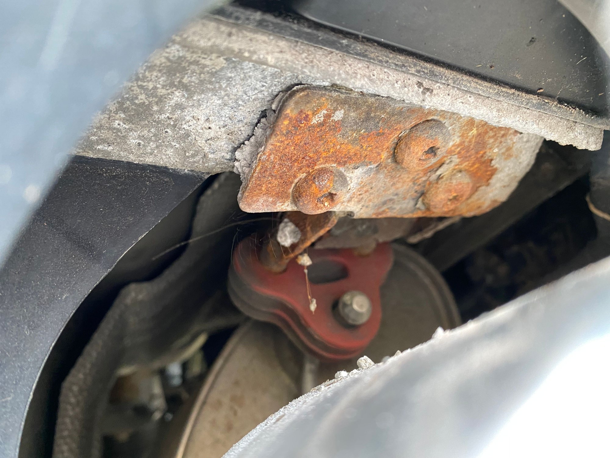

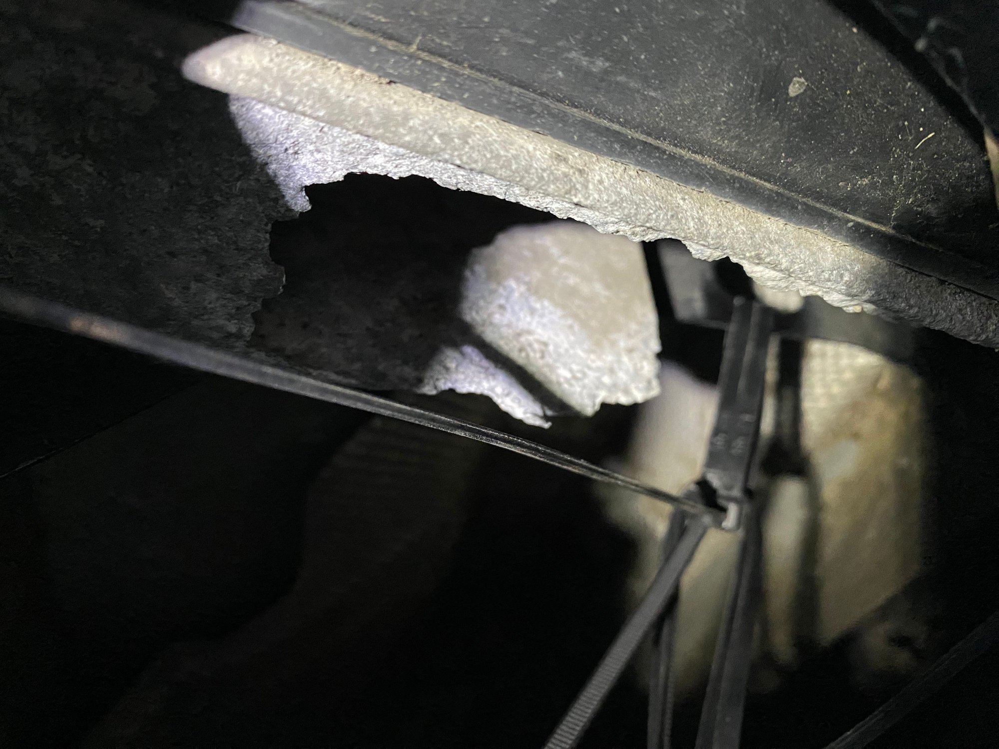

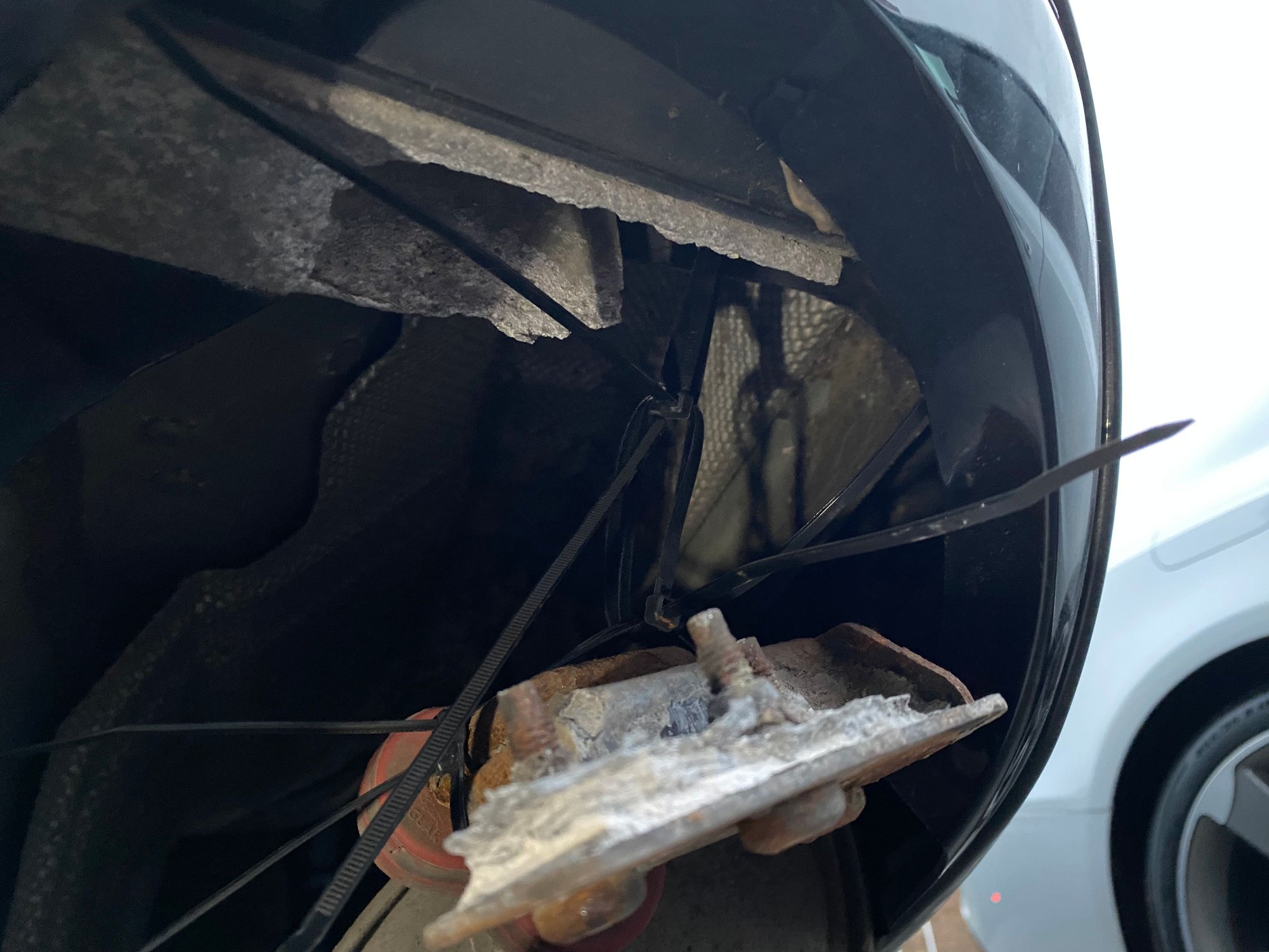

2015 XJL off side exhaust mounting collapsed due to serious aluminium corrosion of mounting bar.
Cracking of aluminium mounting bar where steel plate bolted. IMO Conflict of mounting steel on aluminium
