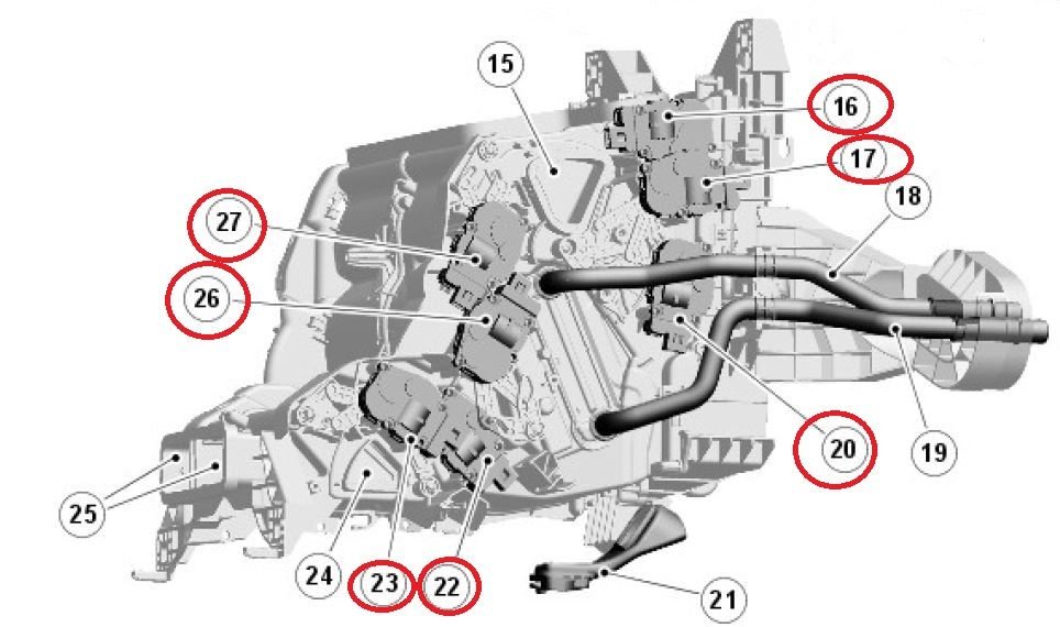

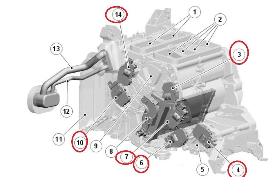

You got me curious and boy oh boy will it be fun to determine which blend door is making the noise!
Here is the HVAC control box inside the dash board. I was shocked at the number of blend doors on the X351! My old STR had maybe 4 blend doors.
These cars have 13 blend doors or now they call them "Stepper Motors". Same thing.
Drivers side of air box.
And the Pasenger side.
Don't know if Jaguar changed this over the X351 lifetime so take these diagrams with a grain of salt until you check the setup for your year of car.
Also don't know how hard it is to get to them for replacement.
