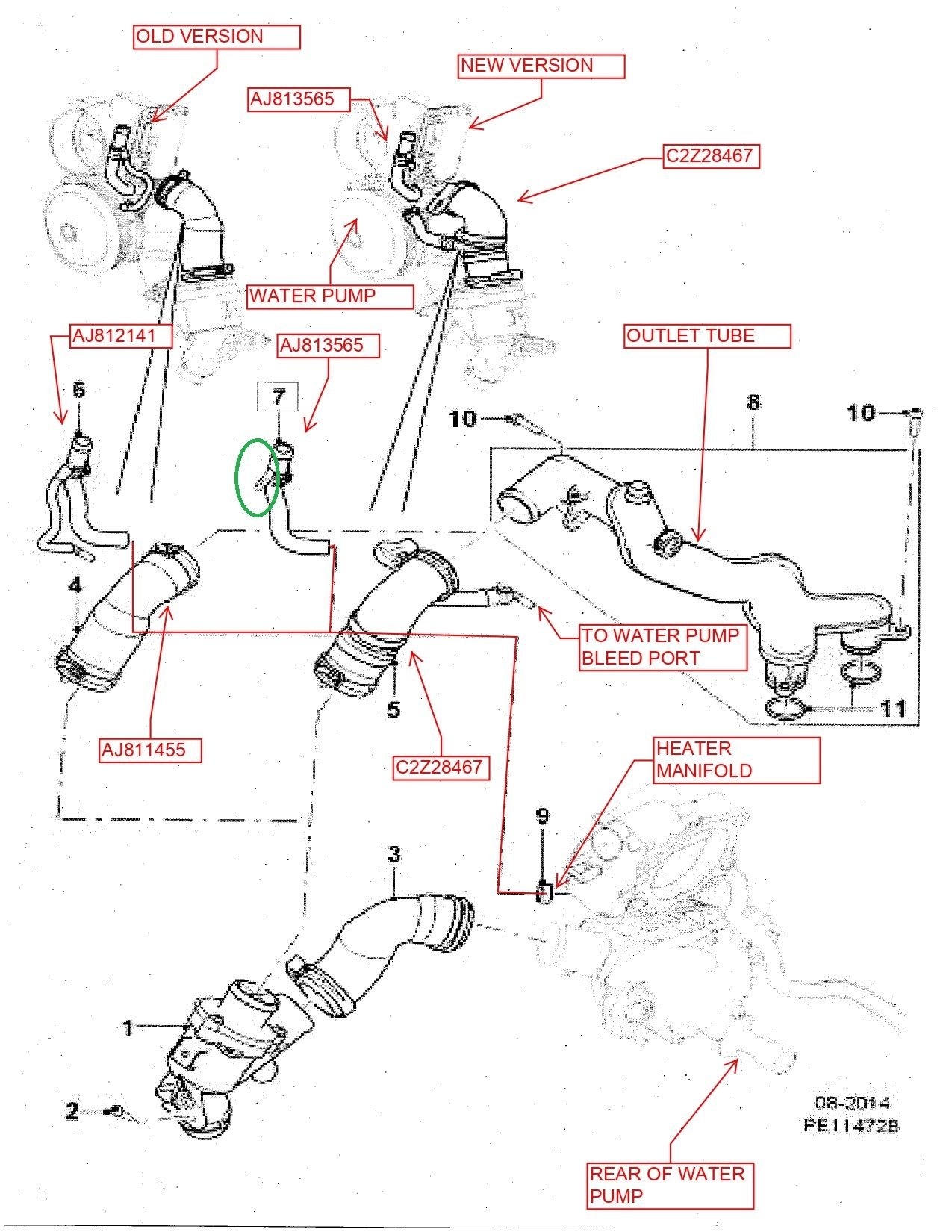

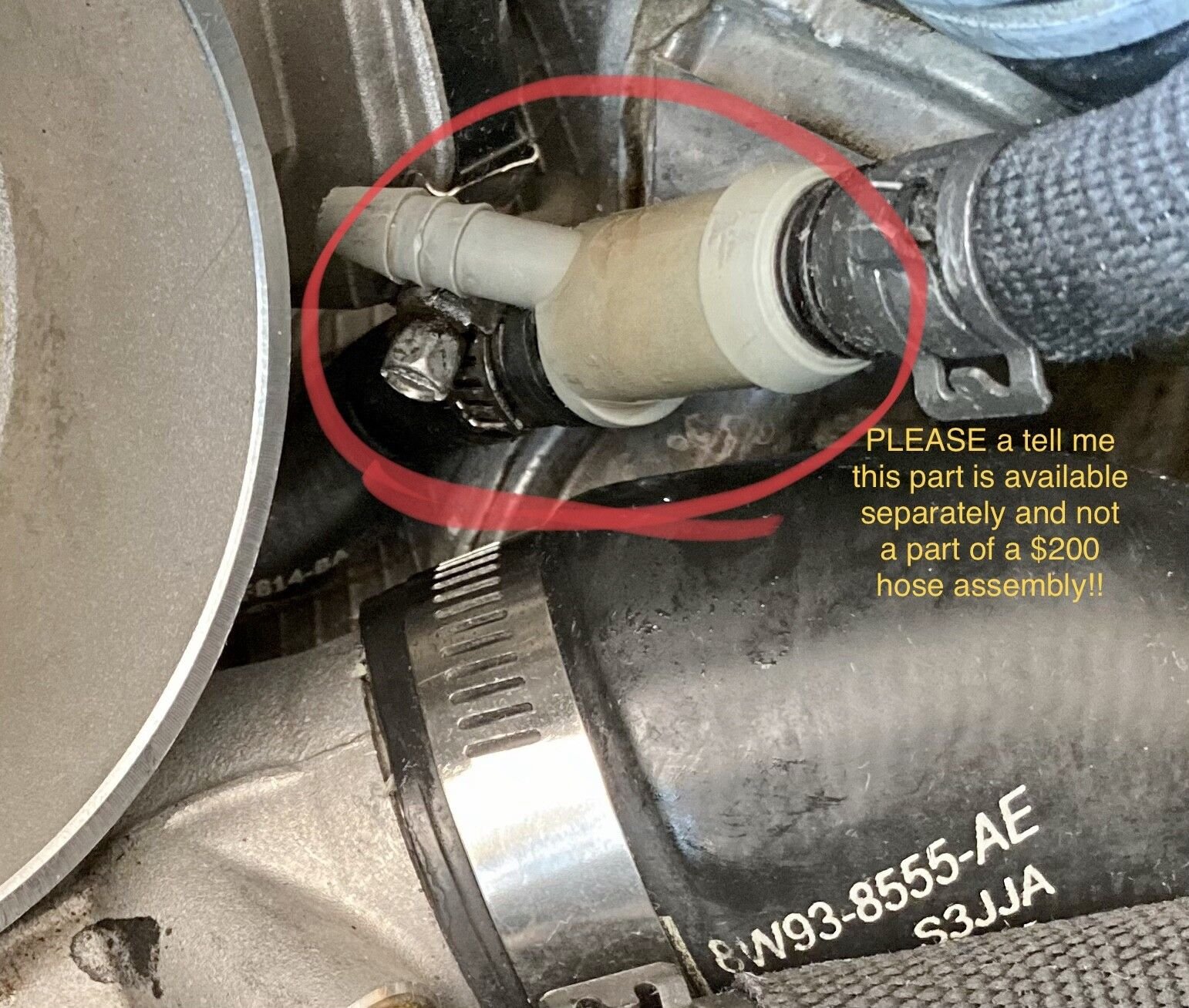

Well, after about a year and half of trouble-free motoring (admittedly, I haven't been driving much since I work at home), the Big Cat began leaking coolant (my fav types of repairs) from the hose that runs under the supercharger and connects to the expansion tank hose. It used to connect to the throttle body but I did a bypass of that many years ago. I believe this plastic connector to be the culprit:
This pic was taken from this post: https://forums.jag-lovers.com/t/diy-...upgrade/409134
Does anybody know what purpose this thing actually serves? That slanted barb has never been attached to anything so far as I remember. I want to just use a brass coupling and a new length of hose and be done with it.

Yes that is a left over remnant from a earlier cooling hose setup. If you look or try to poke something in that nipple you will find it's sealed off and is a dummy only. I think what you want to do should work fine?
Post back with your repair if possible?
This is a bit hard to see but Item #7 shows the empty nipple (Circled in green). Not a great diagram either.
#7 replaced item #6 that did have a rubber hose attached.

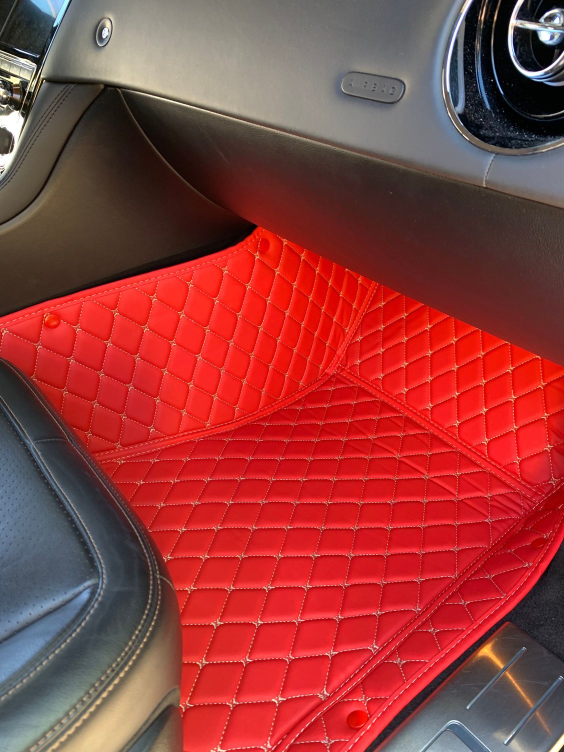

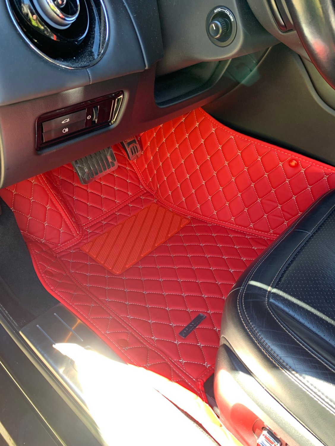

busted out the vacuum
installed new floor mats that match my calipers & tail lights

Love those matts. I already have diamond stitched seats, and afraid to get a set and it be too much.

Well that will save you having to mop up the blood!
You definitely would get a lot of coffin comments if you go further with the diamond stitching.
