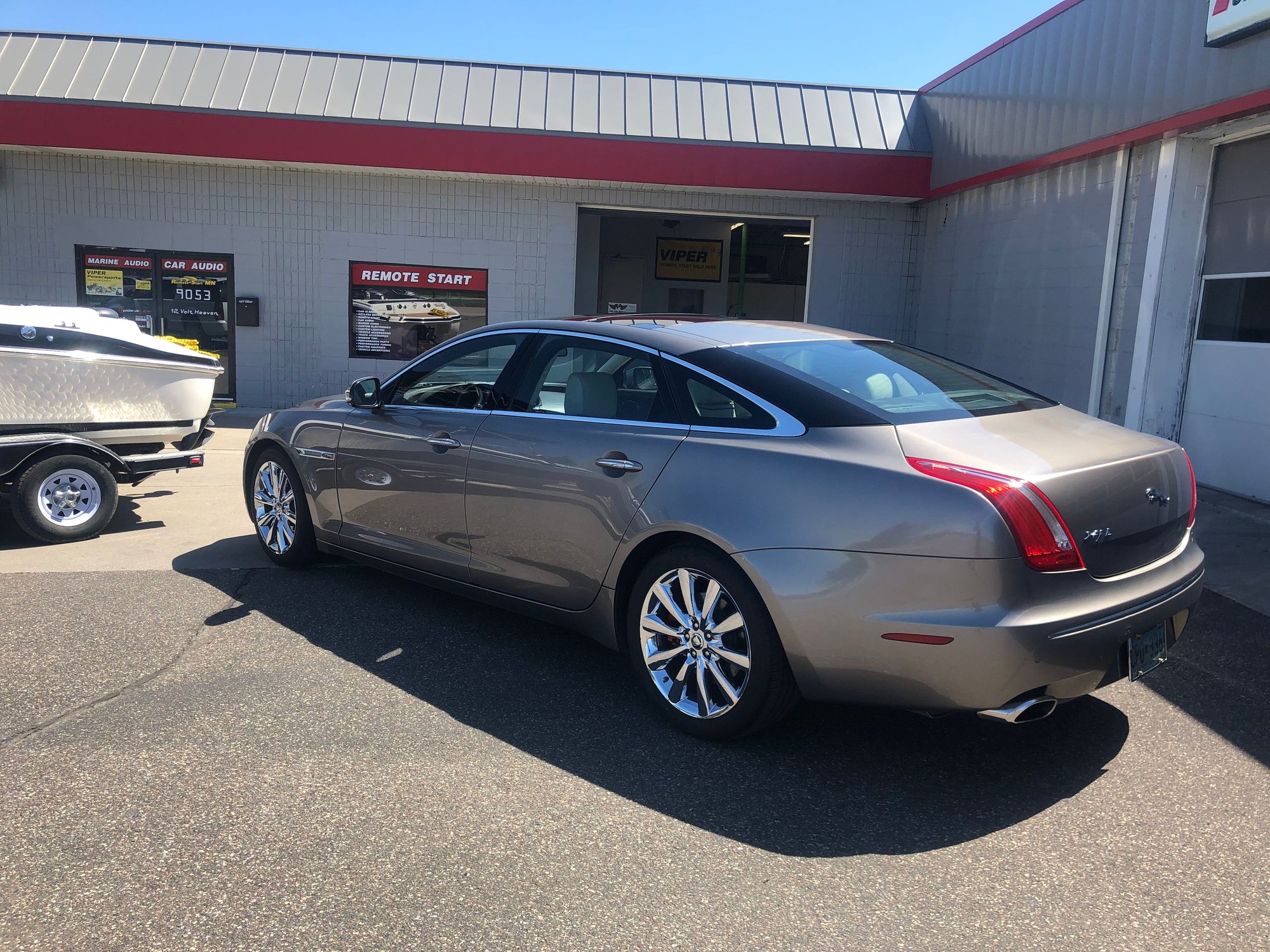

Wow, what a beautiful XJL! I would throw all my money at that too. I hope you can get her fixed to your liking.

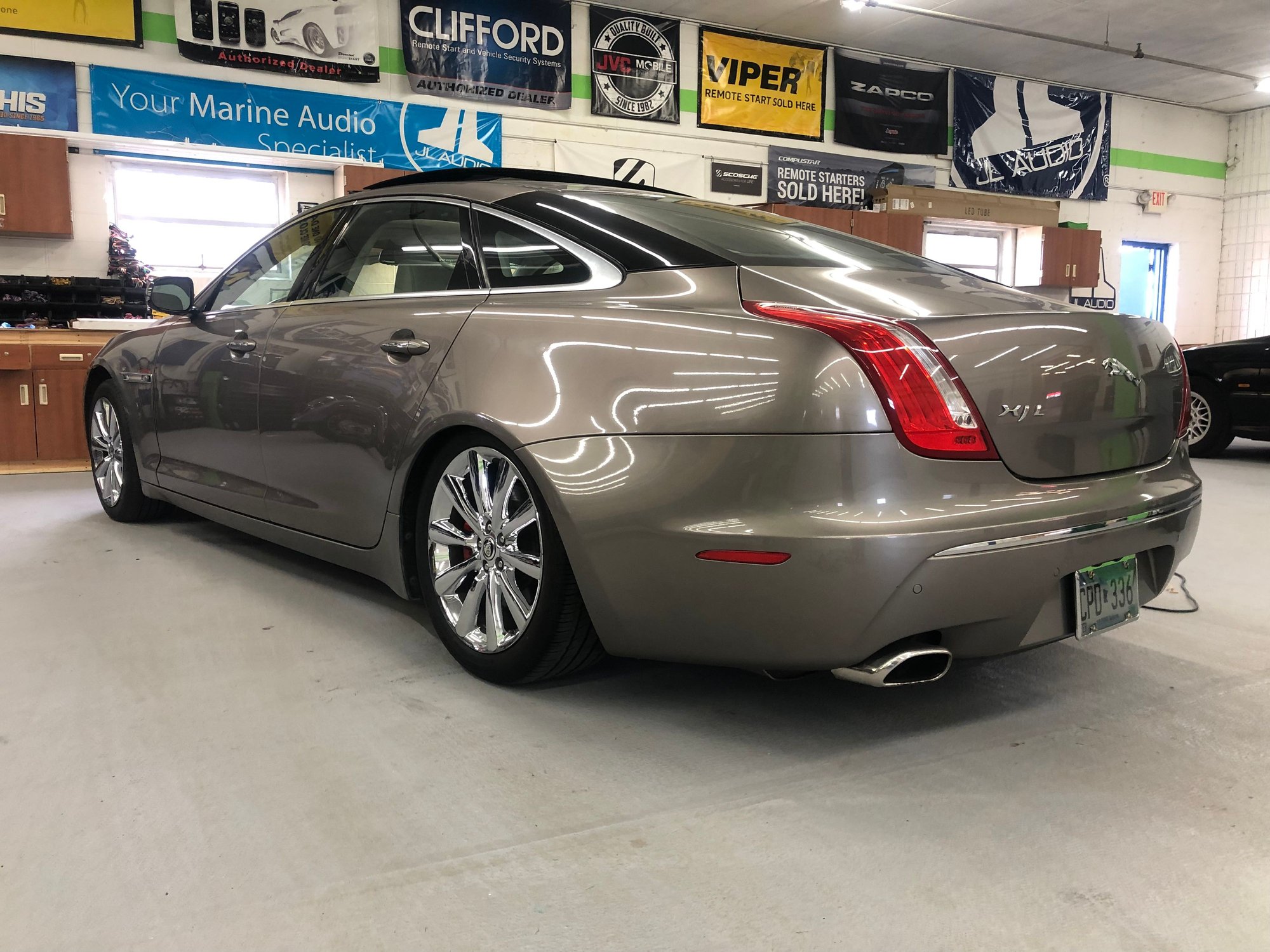

Thanks, this isn’t it’s best camera angle but it’s kind of a cool pic being that you rarely see the car without air in the suspension. I ordered the Continental TPMS sensors that you advised me to get from rock auto yesterday (saved me about $160 over what my mechanic was going to charge for a universal) and they should be here Monday. So as of Tuesday I’ll be completed with following everyone’s advice here and hopefully I’ll have no check engine light, no tire warnings, no rattles or clunks. Looking forward to Tuesday!

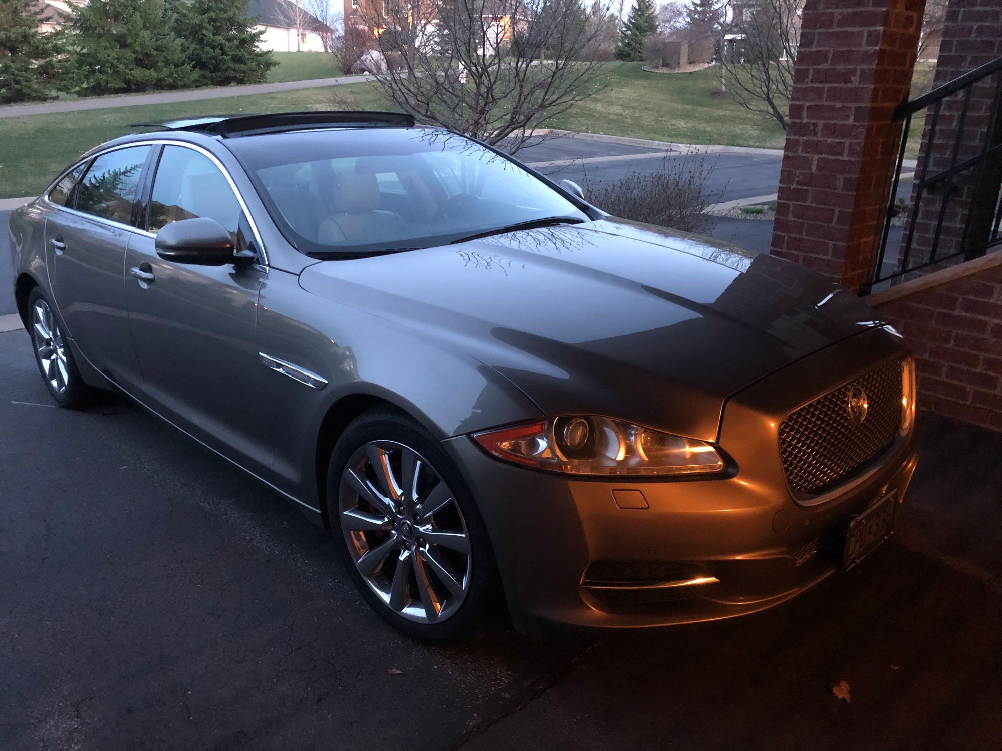

i have to post another of what it looks like normally here and once the car is done to my liking (hopefully Tuesday) I’ll take some time out to get some real pictures
