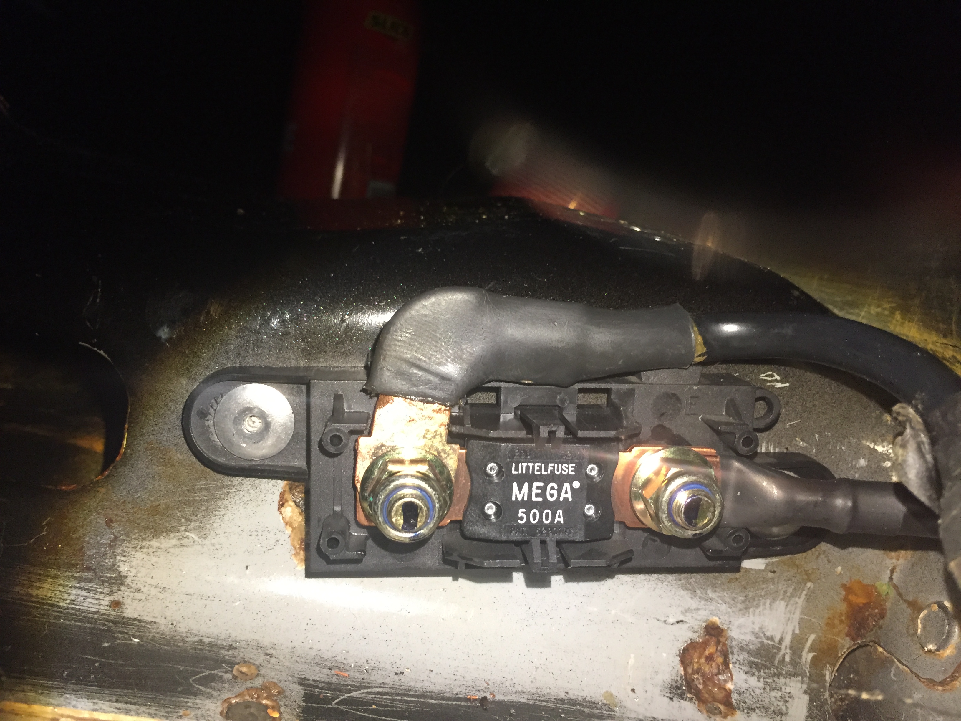

So I got myself a new project - a flooded XJ.
First issue I had was getting to the trunk, then I was assessing the damage - mostly the right side of the car was wet.
That brings me to my issue:
There is a fuse under the carpet called littlelfuse Megafuse - a bit confusing.
To me that seems to be the positive cable.
Does anyone know what is the part number for that cable?
Also I am a bit confused - there is a very similar fuse locate in the front .
Has anyone relocated the fuse before? or was this done on purpose?

It is fresh water - I got lucky - it was motly under the carpet on the right side(more at the front)
However, at the first look, I got really scared - the red thing on the floor is actually mudd/clay - a very fine layer.
I found out when I tried cleaning it. It was cleaning suspiciously easy with Windex. the only place where is actual rust is around that decomposed fuse.
To me it looks like electricity+water accelerated the corrosion a lot. It basically ate the whole positive lug along with the nut.

So I checked and cleaned under the seats, there was some rust but electronically everything was fine
I Used a lot of alcohol CRC cleaner and Paper towels and a ceramic room heater since it was cold as hell during this time.
I had to cut the tip of the wire and install a new copper lug(I checked the section and the copper was still shiny)
The cable was long enough to reach the junction fuse even after the cutting.
To make sure I get really good contact I used wire glue on the crimping section.
I ended up buying a crazy hydraulic crimping tool for the job.

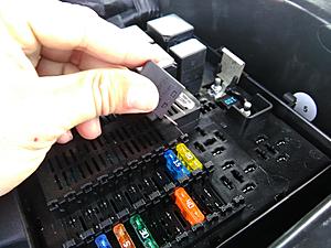

Just in case someone else might have a complete electrical failure here is how you open the boot the easy way:
(If the junction box is dead like mine - there is no other way) :

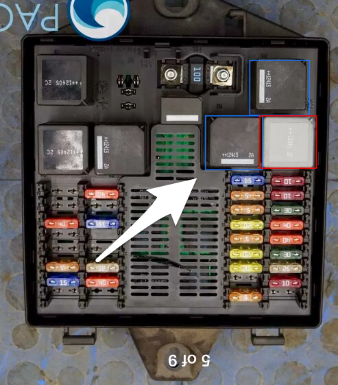

After this it still didn't want to crank - I could hear the relays click but no dice ...
So I went and used a power-probe type device to check the starter ... it turns out it was jammed took it off and disassembled it.
That made the car start - however the starter was still kinda flaky so I ended up replacing it.
Now the relays - I looked many places and I could not find the exact layout so I figured just place all 3 there.
The computer didn't give me any clues but one of them made the rear suspension lift
