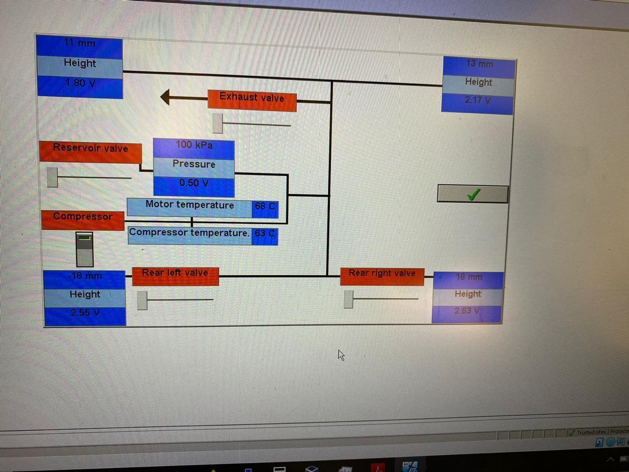

I am trying to calibrate the hight suspension to the default Heights of 386mm and 373mm (front and rear) using the SDD. The Big issues is then I try to do so its comes with some Errors.
Current manual measurement I did is: front left 405mm, front right. 410mm, rear 370 mm and 360mm. This is the best I got by using the "Air Suspension - Ride Level control Module diag interface" on the SDD.
The Problem raise when I try to use the Calibration of the sensor height for the vehicle. I put the default height of 386mm and 373mm and apear the bellow Information.
Need help to setup properly the height.

Hello
The Picture measurement is the best I got. for any reason the rear information one Side is positive and another is negative.
Help
