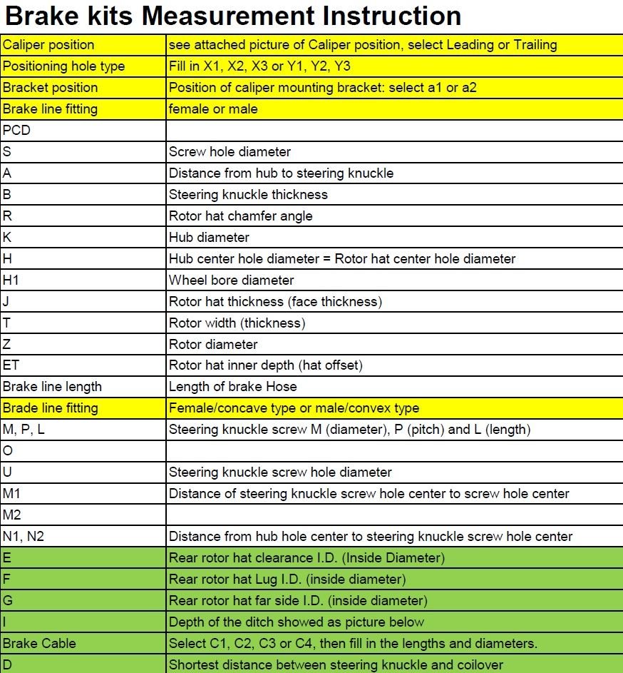

Currently in the process of researching and trying to find out if I can still run my stock rims when I get the big brake kit installed
As this has properly never been done before on an XJL, it is proving to be quite difficult, would appreciate any helpful input regarding the measurements of the required tabs on the table in the picture

Thanks for the reply maybe my post was a bit misleading, I am currently running the stock mativa 20” rims front 9J ET 49 rear 10J ET 46, the new front BBK will require additional clearance at the front of at 5mm, but seeing it's not really safe to be running a 5mm shim/spacer while stock wheel nuts, I’d prob have to get custom forged or at least new rims, Ideally the new offset to accommodate the new calipers should be around ET42 give or take but not sure if I can still keep the rim at 9J or 8.5J
All that aside the most important help I need is really to find accurate measurements illustrated in the table regarding the wheel bore diameter, hub diameter, steering knuckle thickness etc so I can get the new calipers made to be the best fitment possible.
Worst case scenario I would have to buy a wheel hub with a steering knuckle attached and send it to the caliper manufacture for them to check for fitment.
