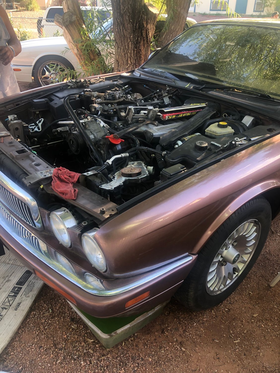

Hello again.
I posted once before about needing the firing order for this car and I got the answer, THANK YOU again to the person that answered me. We have another question, my dads been having a hard time with this car and even took it to a Jag specialist but they couldn’t figure it out either. The issue is, it backfires in the throttle body. He’s changed the plugs and the timing chain is good. What could possibly be the issue?
Need help with figuring out why it backfires in the throttle body. Plugs have been changed, timing chain is good. We’re stumped.

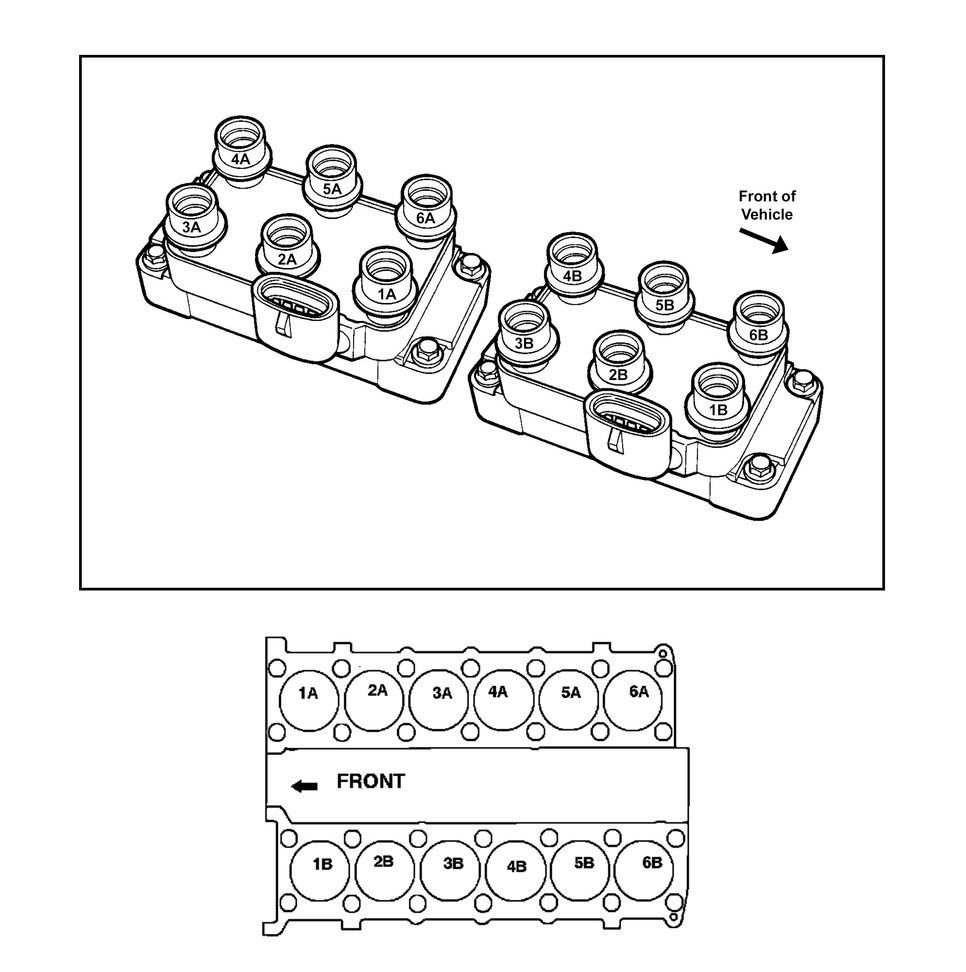

Originally Posted by Nursemnm
Hello. My very first question in this forum was the firing order. Another person provided that, that wasn’t the issue. Wish it was.
Double check from the diagram above.
My main question though was how did this start? These problems are usually the result of something that happened... in my case I fix something and mess something else up. Was the car running ok previously and what was your dad doing to the car before the problem started happening...

He said the car was running perfectly. He changed the power steering pump. He started the car and it was running but it was making noise like something was hitting the fan. He turned it off to check it out and everything looked fine, he restarted it and it wouldn’t run again. That was the last time it ran.

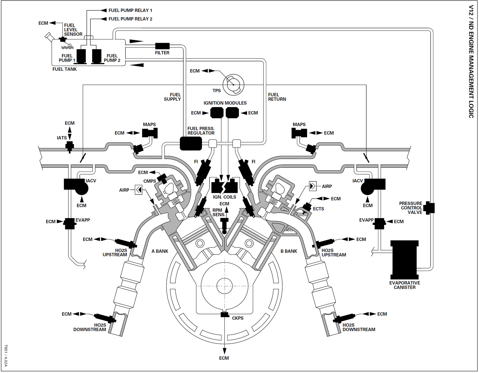

Your new wall picture of your new toy for framing
Note : see the items marked as CKPS ( crankshaft ) , RPM Sens above that , and the CMPS ( camshaft )
http://www.jagrepair.com/images/Trai...20-%202000.pdf
Your check engine light codes are on page 249
The Crankshaft position sensor is on page 222
The RPM engine speed sensor is on page 221 , this is where the fuel pump enable is probably from as well as your Tach

Diagram saved for printing and framing! I hadn't seen that one before. A work of art! Thanks Lady P (who is really a man)! Tip o the hat!

It's a super useful overview of how the engine breathes and when its breath is sniffed!
Did you create it?
