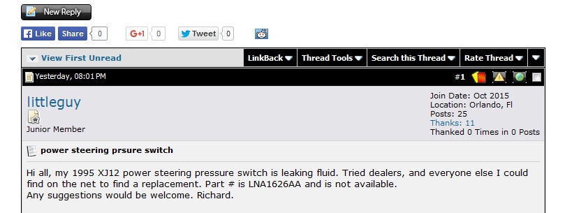

Old Oct 20, 2015 | 05:19 AM
Originally Posted by littleguy
Hi all, my 1995 XJ12 power steering pressure switch is leaking fluid. Tried dealers, and everyone else I could find on the net to find a replacement. Part # is LNA1626AA and is not available.
Any suggestions would be welcome. Richard.
Richard,
I couldn't help fix your pressure switch but I did fix your thread title.
Good luck with the search for a replacement.
