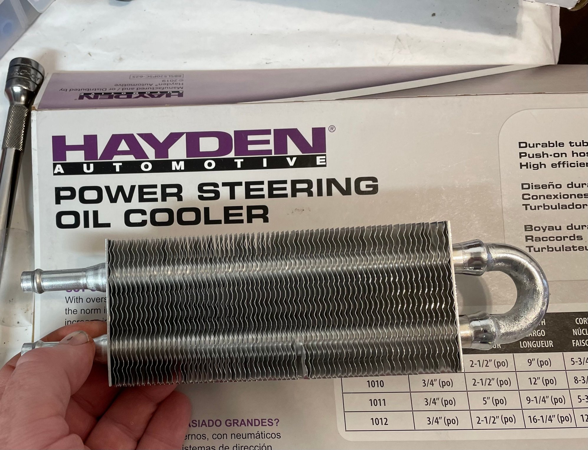

So here’s what we’re going with…. An external power steering cooler zip tied to the radiator. The old ps cooler in radiator is simply abandoned.
$35 on Amazon. This $900 XJ12 Is already well over the $£€ it deserves.
