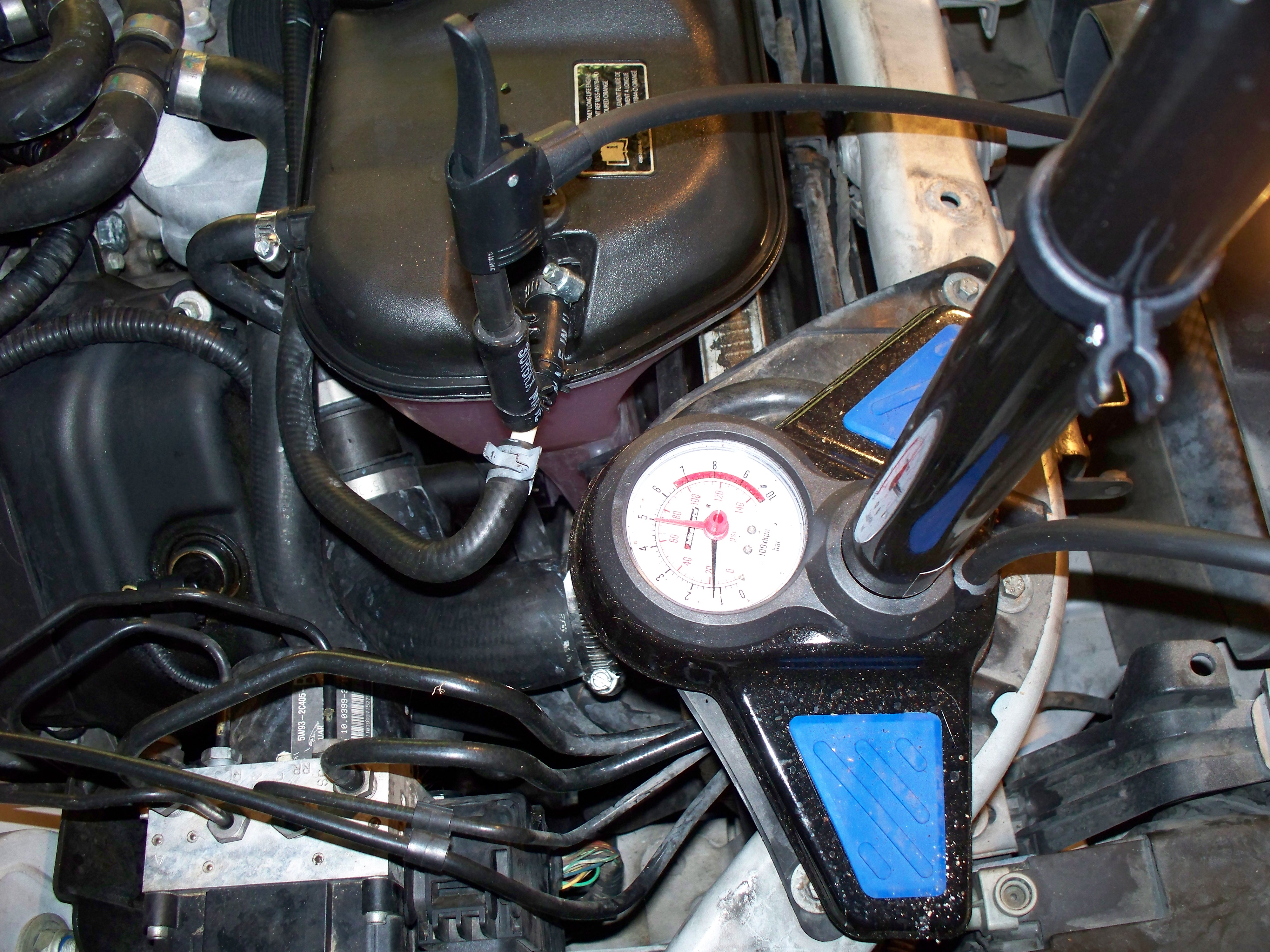

My 05 Super V/8 sprayed coolant onto the engine cover as well. Pressure tested the system and found a small hose under the upper radiator hose had split. It runs over to the right and down to a metal line which I believe is a heater hose/ pipe combination. I replaced that small hose and upper hose as insurance and replaced the original 10 year old radiator cap. Parking down hill has no relation to air in the system. If you had air, the temp gauge would not have registered hot. For a gauge to move, it must have coolant surrounding the sender in the system. Pressure test it at 15/16 PSI and I think you'll find your leak.

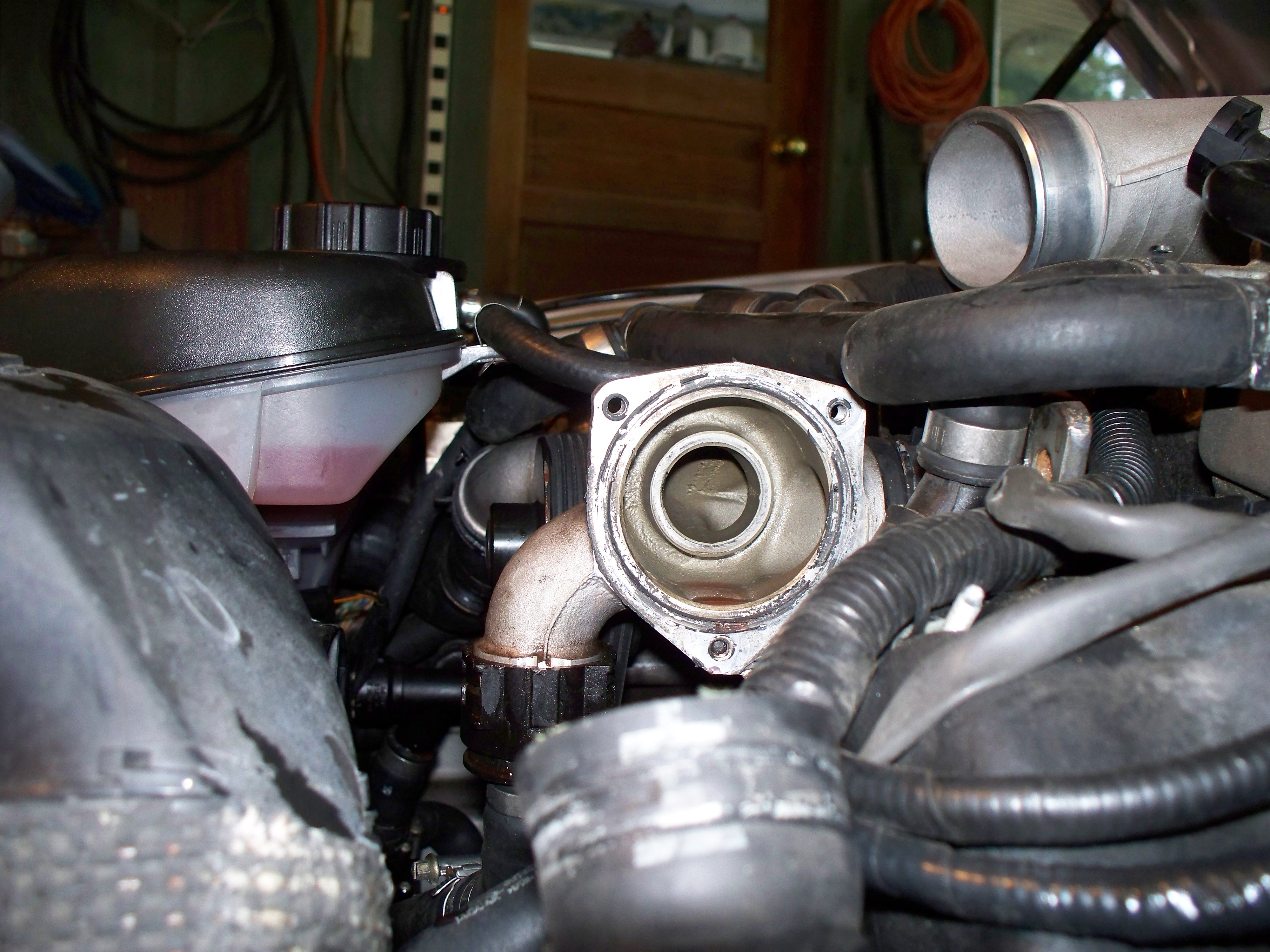

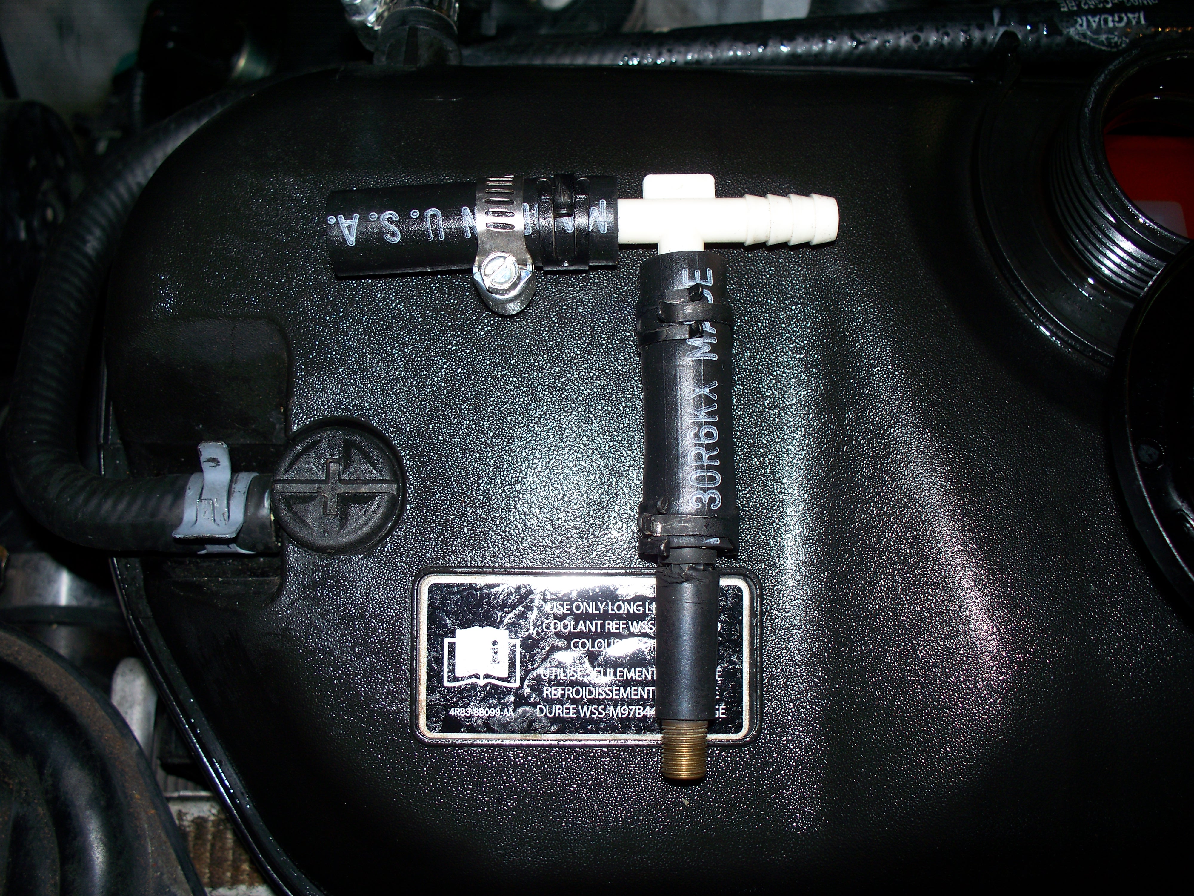

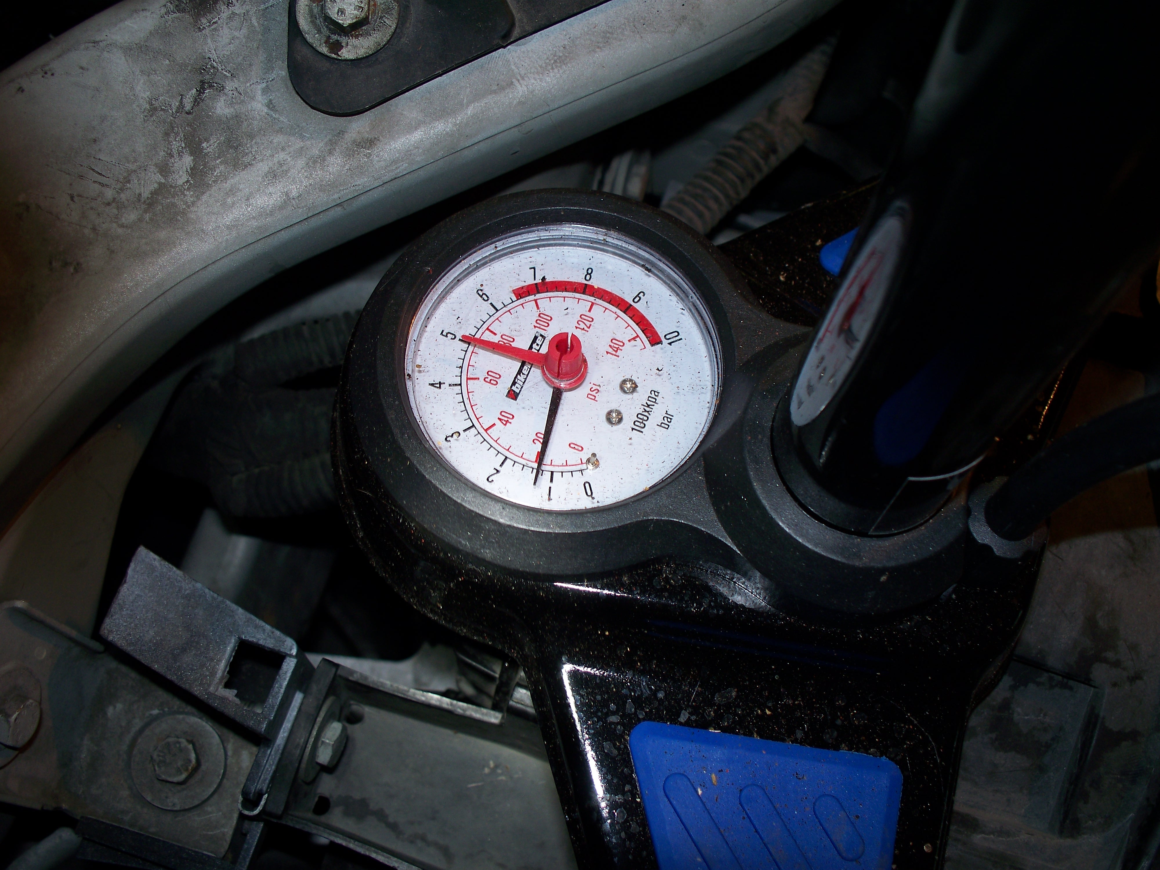

I'll see if I can rig up a pressure test and check for leaks tomorrow. I have to study up to see exactly where the thermostat is, and I do have an IR thermometer.
Today was a "start slow and taper off" day after spending yesterday in the heat loading the SV8 and then having the oil light come on in my tow Jeep and its oil cap twist off when I tried to remove it to add a quart of oil; I had to rig a funnel from cardboard and drizzle a quart of oil down the dip stick tube for the drive home. I'll have to deal with the Jeep's oil cap later.
I had overheating issues last summer that I just couldn't figure out. No leaks, everything was functioning perfectly...except for the fan. Sometimes it would work, sometimes it wouldn't. I finally realized it when I had the AC on and it wasn't blowing cold. The fan should also turn on with the AC, and mine wasn't doing so half of the time. I replaced the fan and the coolant temp sensor and everything has been fine since.

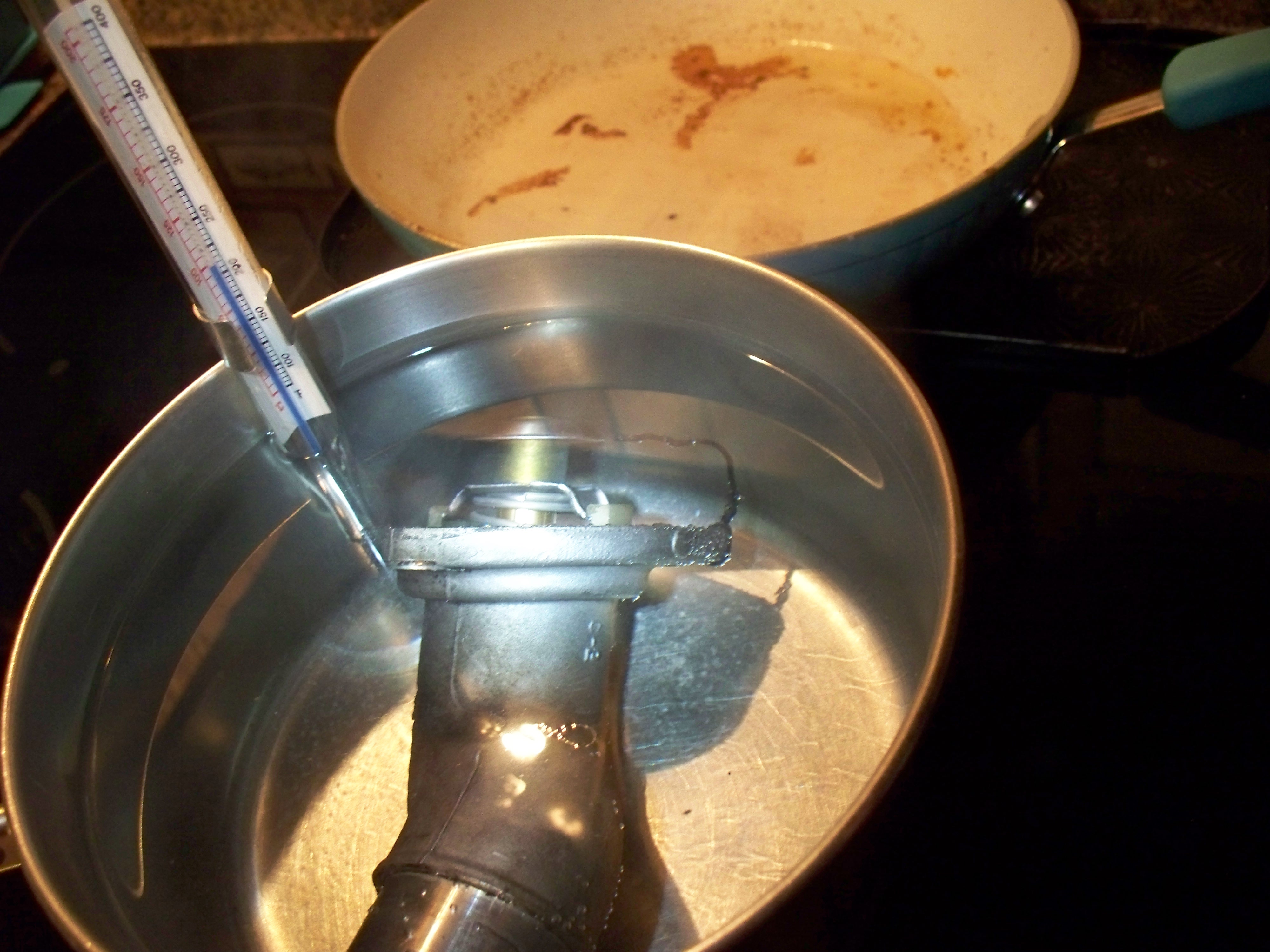

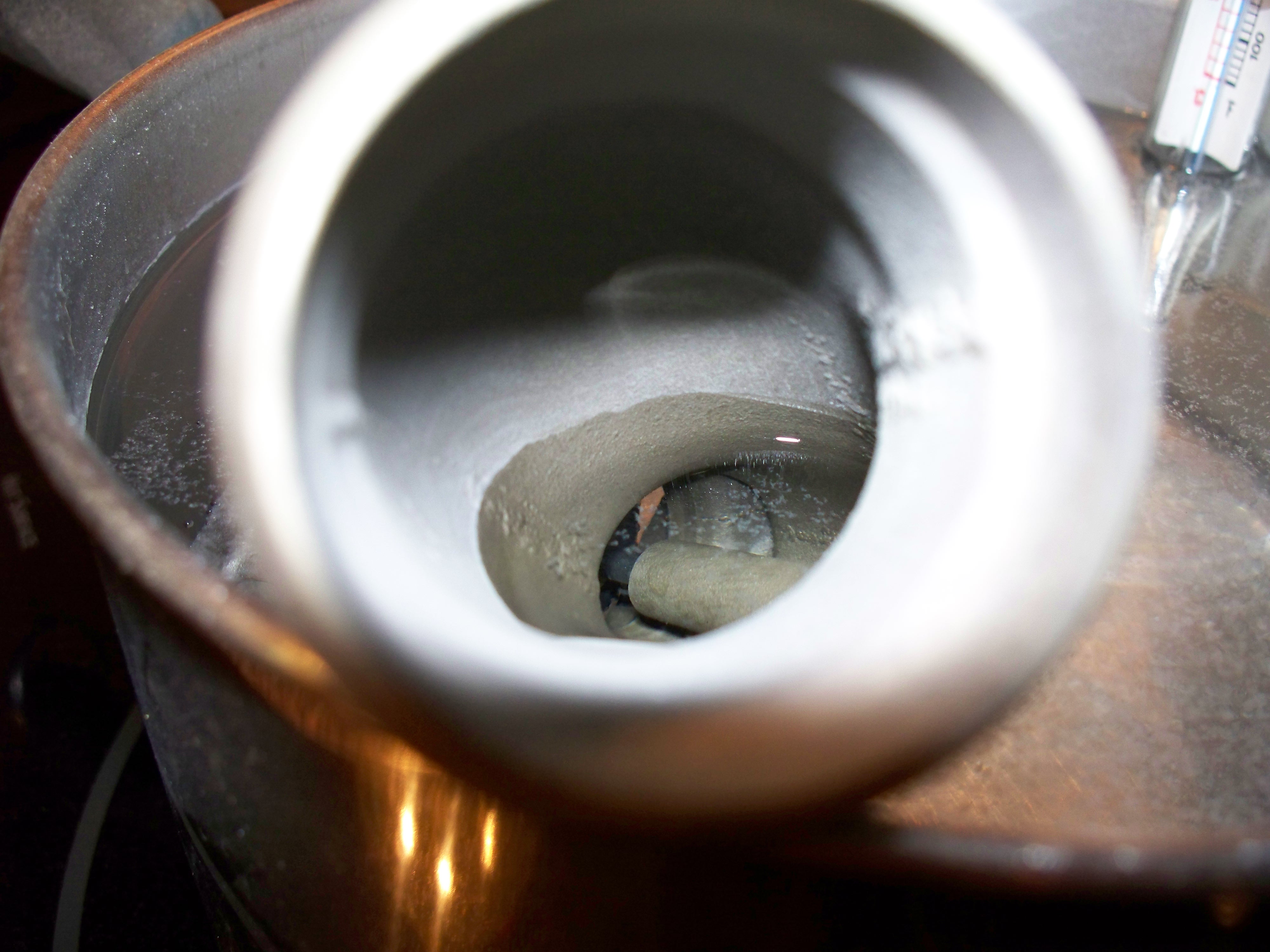

I can't find a description of how this T-stat is supposed to work; Are both ends supposed to retract?
The spec in the manual says "On the 4.2L supercharged engine the thermostat begins to open at 84°C (183°F) and is fully open at 98°C (208°F)", so I am guessing this one must have failed if is is supposed to uncover the seat in the housing to the hose and the seat in the block at the same time.
What is a good source for a new one? Local parts house web sites show a more normal T-stat and not this one, and ebay shows a whole raft of the wrong ones saying they fit my car. I checked merriam and theirs is $45 including the seal. Sound about right? At least from them it should be the right thing.

The thermostat and seal arrived from Merriam at noon yesterday and I got it installed in the housing by stacking the components with the top hat against a block on the floor pressing down against the very heavy big spring and turning it so the bracket ends located in the tab slots on the housing; took several tries. I tested it in a pan of water on the stove and the top hat still does not move (guess it isn’t supposed to) and the rubber edged disk did appear to open a little farther at 212 F than the old one but not much. I reinstalled the T-stat housing in the SV8 and I started to remove the bleed screw from the reservoir but coolant bubbled out so I re-tightened it (barely hand tight - spec says 1 Nm which is 9 inch pounds), topped up the reservoir to the max step (which took half a gallon or more), and went inside to escape the mosquitos.
This mornning I removed the reservoir pressure cap and bleed screw (coolant did not come out of bleed screw this time) and the level in the reservoir went down. I refilled the reservoir to the max step and coolant appeared in the bottom of the bleed screw hole. I reinstalled the bleed screw and the pressure cap and made up a pressure testing device with a Schrader valve stem on a ¼” T and installed it between the vent hose and the vent nipple just below the bleed screw on the coolant tank. I used a bicycle pump to pressurize the system intending to do it at 14 PSI, but I hit just under 20 PSI or 1.1 bar on the bicycle pump gage. I left it for an hour and the pressure did not go down until I loosened the pressure cap and coolant bubbled out around it and was then above the max step in the reservoir. When I removed the T, the coolant level in the tank dropped again, so after I reinstalled the vent hose I removed the bleed screw, topped up the coolant to the max step again, and reinstalled the bleed screw and pressure cap.
