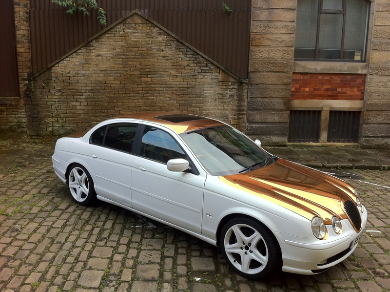

Ive owned jags since i was 21, now 25. This is my other Jag, S-type, 3.0 V6, running on LPG

Your S-type looks lovely !

BTW is that vinyl wrap on the S Type?
You've still got the S-Type. I didn't think there'd be two with that very distinctive colour scheme.

Can't give my thumbs up on the gold top-side, but the XJ's 19-inch Custom style wheels look great on the s-type, good choice. If the gold were white, that would be a stunning vehicle. But no pic of the recovering x350?
