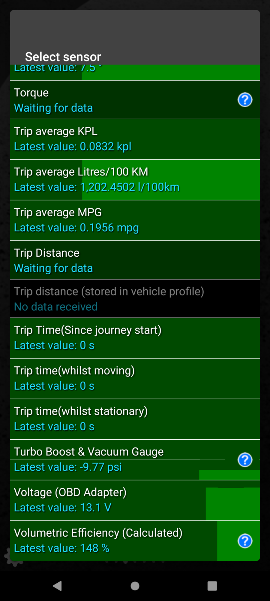

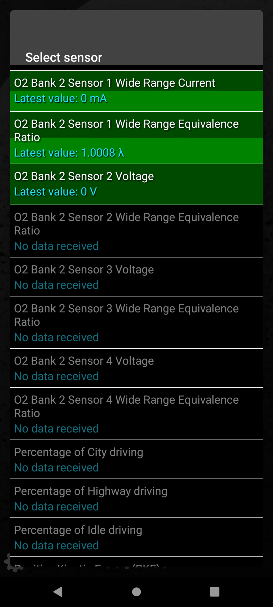

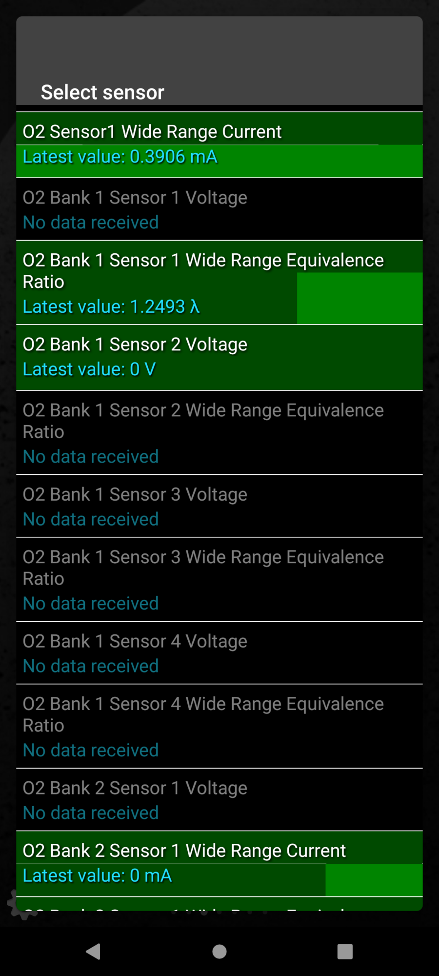

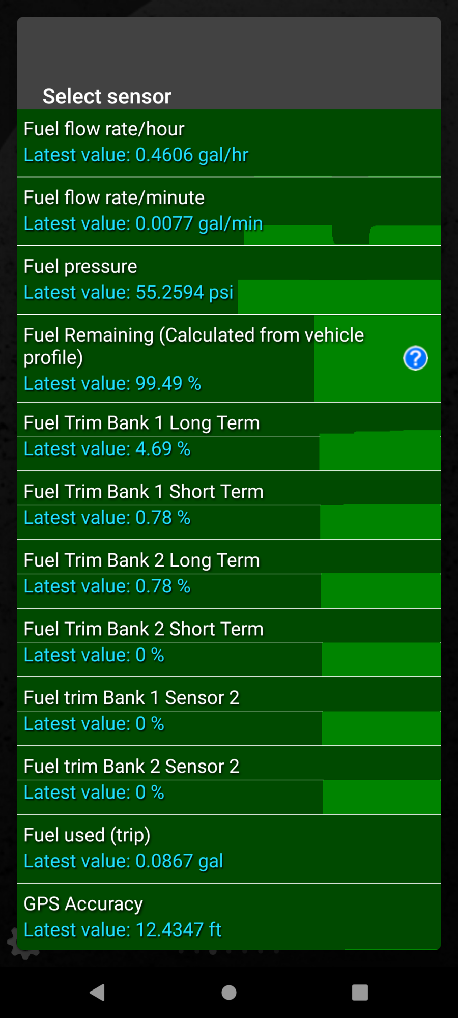

Okay, so reporting back, I'm sure the downstream O2 sensors have been cooked. I pulled the plug on one and tried to ohm across the terminals, and it would not show any continuity at all, which is confirmed by the scans below. What is the preferred O2 sensor for the 4.2? Denso? (Looks like the OE Manfucturer)

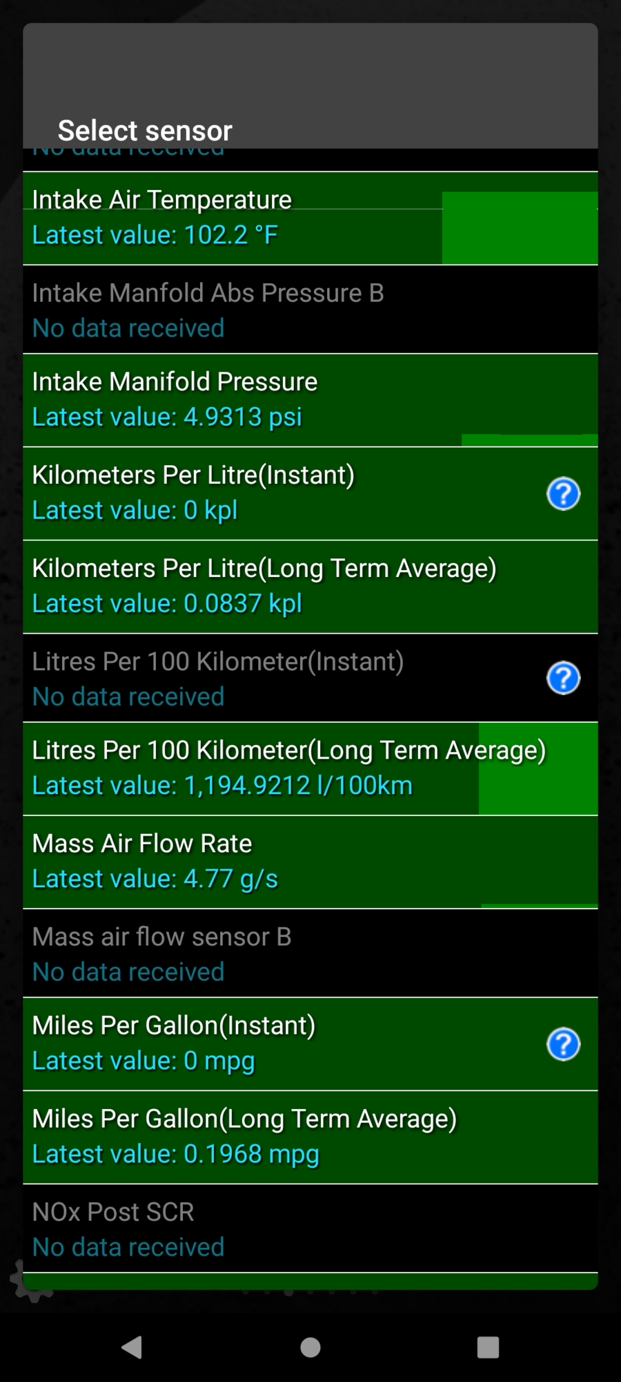

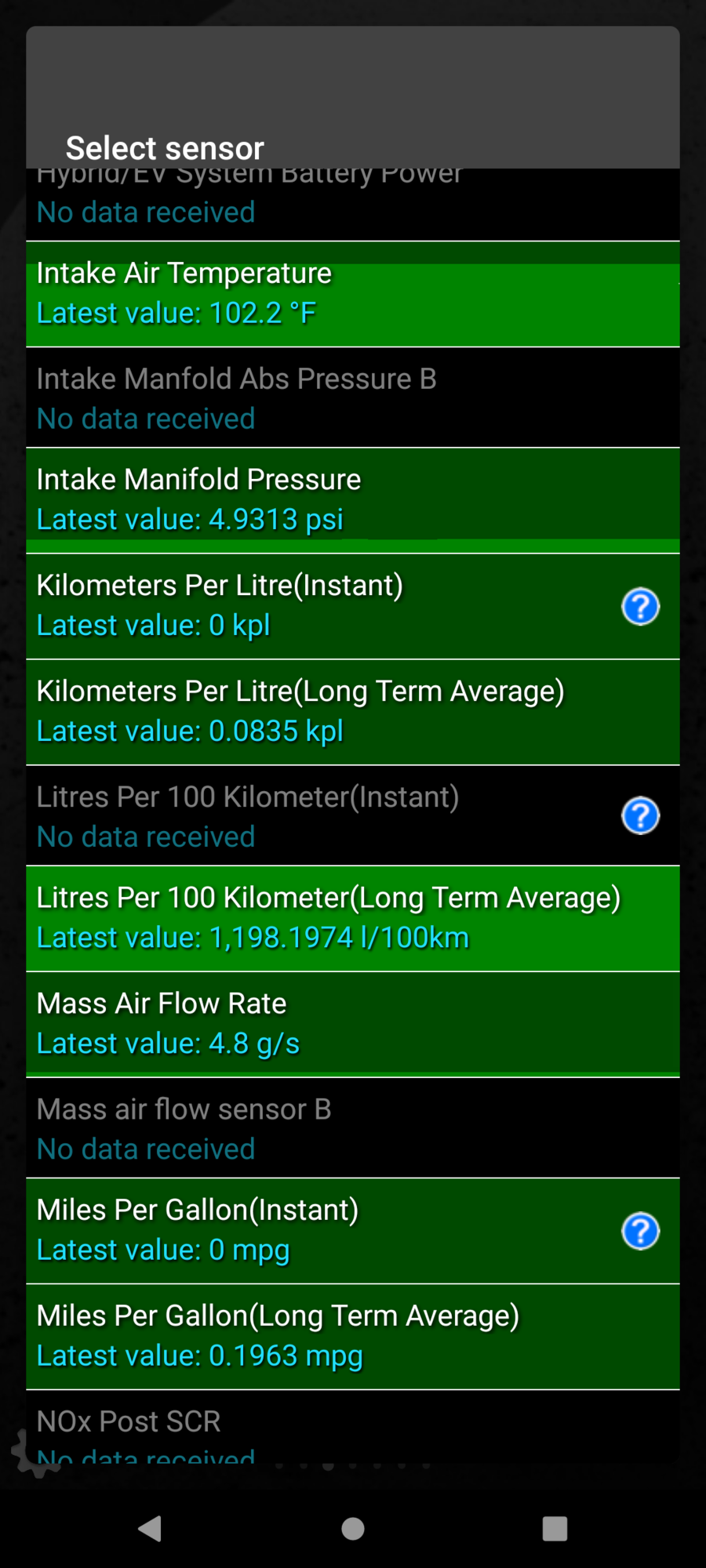

The MAFS was super dirty, so I cleaned it with CRC MAF Sensor Cleaner, along with the throttle body and the car also seemed to idle much better on initial warm up.
The Vavle Cover Gaskets are also leaking like a sieve. Anyone have good luck with the MAHLE Kit?
It was also throwing an intermittent code for a coil on #6, which didn't reappear in the scans after clearing them initially, so going to get a coil. My local NAPA is showing Echlin as the OE for this coil? The 4.2 is slightly different than the 4.0s I've been working on, where Denso was the OE for coils.
Anyway, any comments are preferred but going to try and knock this out on a Saturday with him. If anyone sees anything out of the ordinary with fuel trim data, etc., please let me know.
Scans here:
OBDII Scans

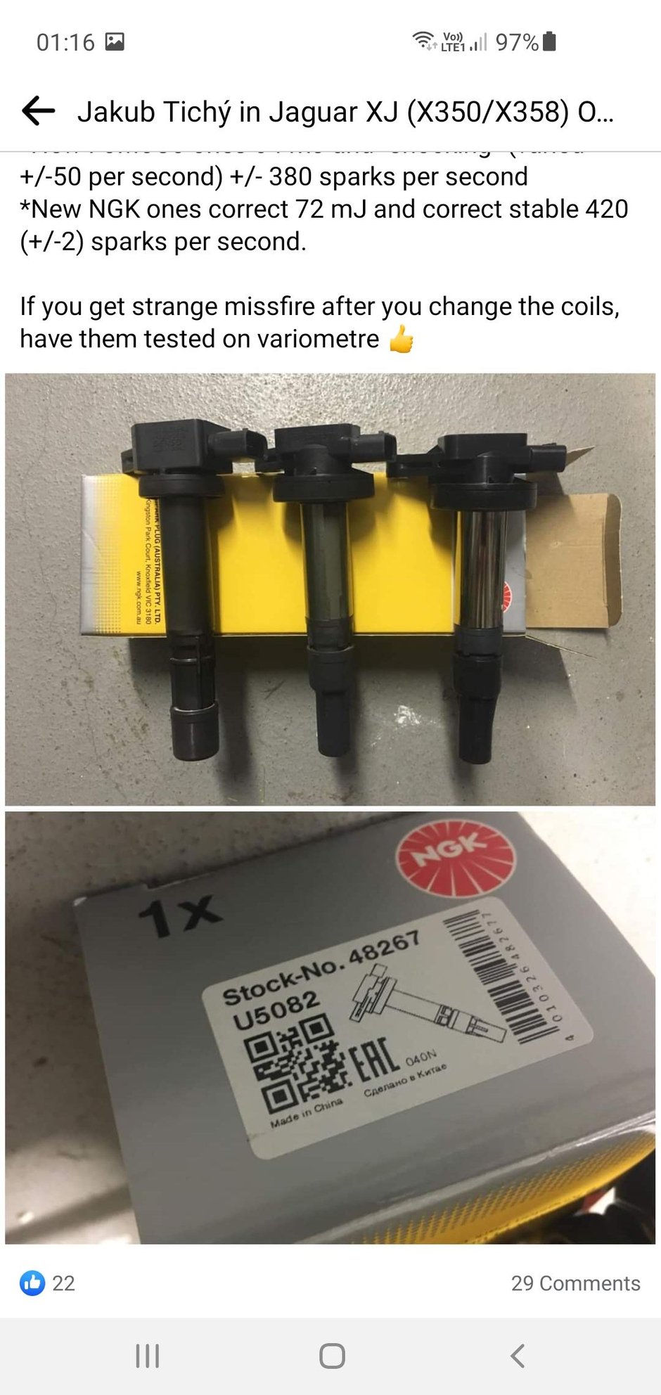

maf cleaned airfilter clean ,coil and sparkplug at least have a look at number six.
you might want to change and experience position another original coil from same bank.obd check.
if the o2 sensor is rattling when shaking it is shot .
these have been tested and had the best result but check if these are the right ones. . I do not remember if 4,2 xjx or 4,2 Na.
fuelfilter is underneath B pillar left side hidden underneath the plastic cover

coil ngk 48267 na and xjr

Sounds like you have a plan and are knocking out the problems one by one!
Post back as you make progress.
Yes Denso 02 sensors.
