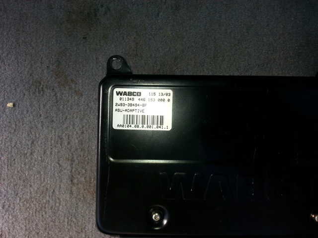

When I went to plug into the OBD system, the plug was not in place, I couldn't find it in a brief search under the dash. See pic #1.

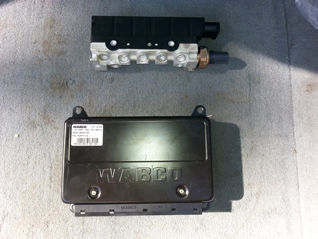

He also left two items in the trunk. One looks like an air manifold, the other looks like a computer module. See pics #2 and #3.
Can you guys tell me what could have happened to the OBD port? I guess it is probably tucked up behind the dash somewhere?
Can you tell me what the two units left in the trunk are?
What would be the best way to approach fixing this car? Rip all the air suspension stuff out and put coil conversions on it? Replace the "computer" module the guy burned up? Or just sell it for next to nothing and be done with it?

That is definitely where the obdii port should be..
As for those parts, that's the computer and the air distribution block for the suspension.
I'm not sure why the hell he would have pulled those units....no need to do that to replace any other suspension component. Also no reason to unplug the unit...

And as i say cheaper can be alot more expensive. That valve block should never have been replaced nor the computer. If you have a air leak you have aair leak fix that not replace everything cause you dont know how to diag and fix it. Oldmots, you got a typo on prices
if they put a module in it has to be programmed and the cars air suspension has to be calibrated. Both dealer only issues without correct software.
Look under the dash and feel, obd2 connectors can pop out, they just snap in place
