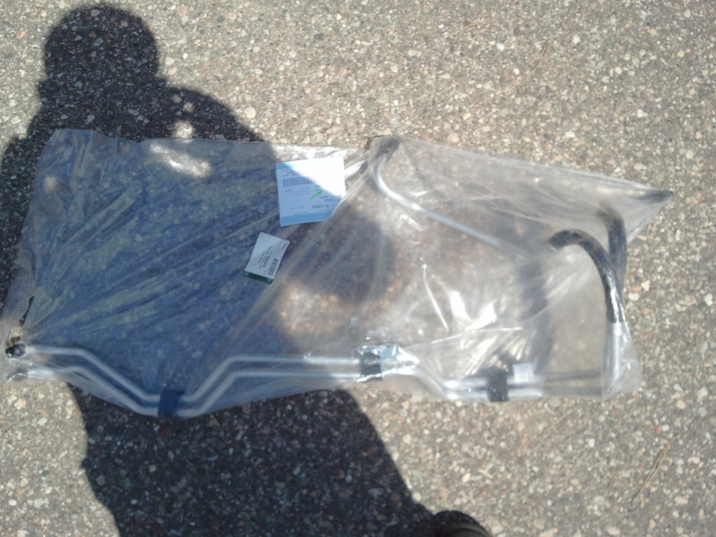

Old Apr 27, 2013 | 11:25 PM
Casper's Avatar
Joined: Mar 2011
Posts: 261
Likes: 60
From: Novi, Michigan
Mine is leaking too so I got new line just waiting to put it on.
Attached Thumbnails 2004 xj8 transmission line leak-2013-04-27124532_zps166d3bea.jpg

Casper,
How much did you pay for the lines?
Old Apr 28, 2013 | 06:12 PM
Casper's Avatar
Joined: Mar 2011
Posts: 261
Likes: 60
I can't remember the exact number because I don't have the receipt with me but it's either 209 or 219 for the set from a dealer farther away from me. the dealer that is closer to me like maybe 2 miles away wanted 289 for it. So I drove 45 min to get it while going that way for a meal.

Hello Casper do you have the part number. Thanks
Old Apr 29, 2013 | 10:22 PM
Casper's Avatar
Joined: Mar 2011
Posts: 261
Likes: 60
C2c40418
