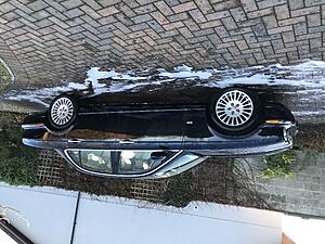

Hi - I didn't think any of them had the door rub strips, here it is. It's a late MY2005, VIN ends G48694

it’s absolutely an early x356, brakes and no rub strips are in instant giveaway. all the relevant parts start with 5w93
http://jagrepair.com/images/Electrical/XJElectrical/2006%20MY%20XJ%20Technical%20Guide.pdf

I concur with Xalty that your car seems to be an early X356, at least from the picture you sent, and as such it may be that it needs the additional module.
It seems that the VIN is not a 100% giveaway, apologies if I created confusion!
Unfortunately, it can happen,a nd not only with Jaguar, but with other brands, as well, that in transitions the parts installed in a car during manufacturing are not officially compatible with the VIN.
