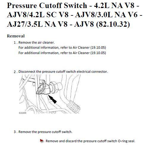

I have been having intermittent A/C issues, which I have narrowed down to the pressure switch... I have one, but where the heck is it located ??? Anyone have a diagram ?

Under the air cleaner it appears.

Got it - thanks !!
