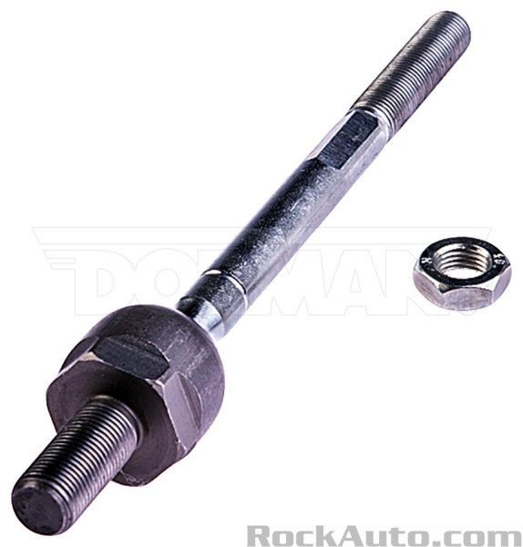

The actuak tie rod is a replaceable item.
So you didn't really need a complete rack. However, did they actually fit one ? Any mechanic worth his skills would just replace the tie rod, as its much cheaper. Of course if the rack was found to be leaking fluid, then yes, a replacement is best.

Originally Posted by IWannaGoFast
Paid some of it with cash, some of it on credit card. Was a $1200+ bill.
How about showing them the Rockauto part shown above and seeing what they say? That is if you up to a "bit of an arguement.
If they have a website state that you will leave an appropriate response.
