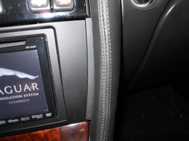

Hopefully the pics attached to this reply. Nice thing about the AVIC's is that you can upload your own splash screen (the screen shot when the vehicle first starts up). So I located Jag's stock screen shot and uploaded it to the head unit. You can see in the pics the gasket material I had to add to the sides to make it work with the XJ. I think you can get them in piano black, but I wasn't going to shop around when I didn't even know if it would fit... now that I do know, a piano black one would be even better.

The next step is get a front panel like in the pic earlier by Greg... ; these are on AMazon - mine came from the states for about $12.
You have to take out whole centre console but it's not difficult once you know how and also the aircon and stereo come out as one unit and then separate.
The facia panel won;t fit exactly - they only do them for X and S type and you end up wwith a small gap down the sides - Gregr put strips over this but actually it's not noticable and I didn;t bother. MOre noticable is that they don't come in piano black and I wish I'd sprayed mine with a gloss black before fitting.
