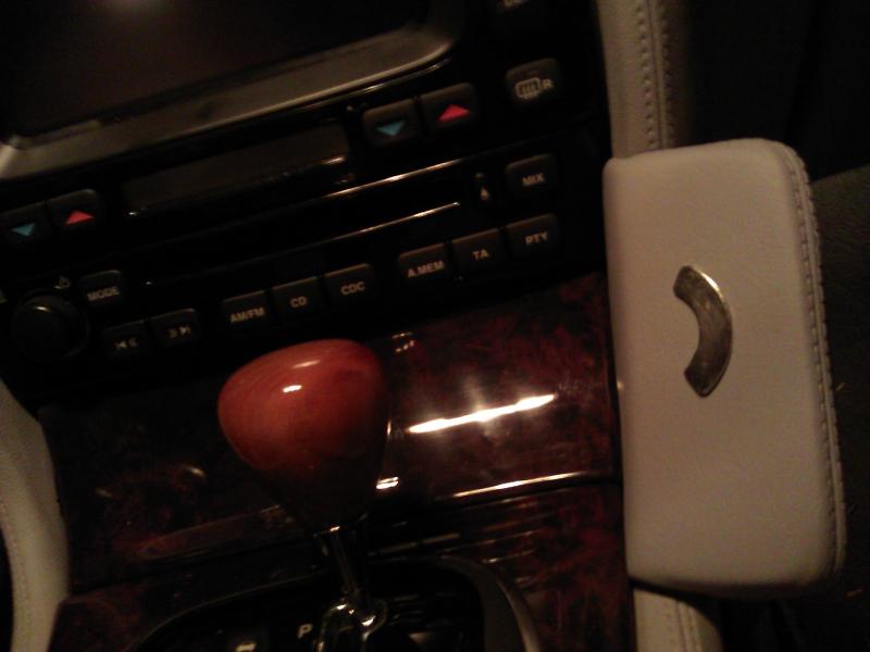

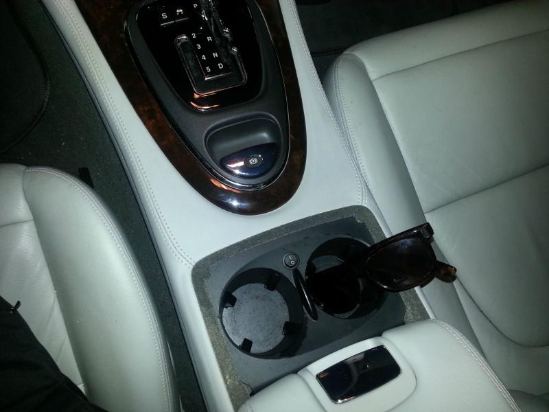

So, here's some pictures and video! Sorry for the quality (and my rambling nature). I had to use my ancient cell phone to film this because my other phone was being used in the demo.
The whole setup consists of:
1) A Kuda mount, fitted with neodymium magnets scavenged from an old hard drive to allow me to magnetically stick my phone to the Kuda without any mounting brackets or whatnot - in conjunction with the magnetic Powermat case I use on my phone
2) iSimple FM modulator kit with antenna adapters
3) Blackberry stereo gateway connected to the modulator, hidden inside the Kuda mount, wirelessly connected to the phone
I found the easiest place to tap for power was off the rear cigarette lighter. Installation was a lot easier than I expected. I've had most of the parts to do this for over a year, but I was afraid I'd ruin something when trying to take the center console out. It's actually dead simple (thanks to gbs28173's simple instructions above).

Mount in action
Very strong neodymium magnet holds the phone in its place.
Mid-installation.
The Blackberry bluetooth stereo gateway, hidden in the Kuda mount.
The button that turns the FM modulator on and off.
Attached Thumbnails Another aux input option - anyone tried?-rrnd4.jpg   Another aux input option - anyone tried?-uh94q.jpg   Another aux input option - anyone tried?-4yurn.jpg   Another aux input option - anyone tried?-asduk.jpg   Another aux input option - anyone tried?-zrn8n.jpg

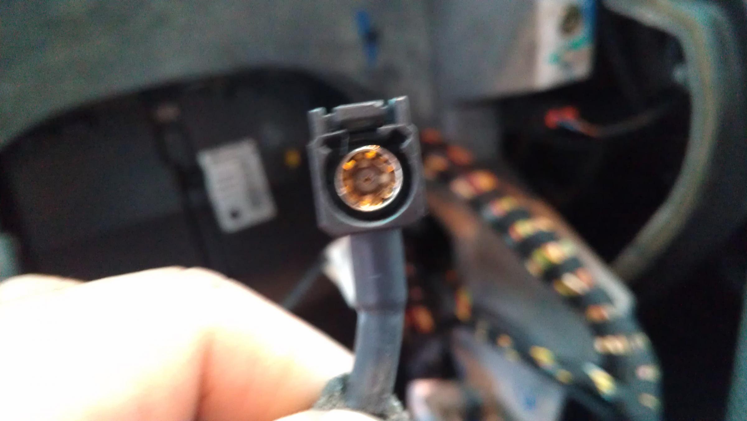

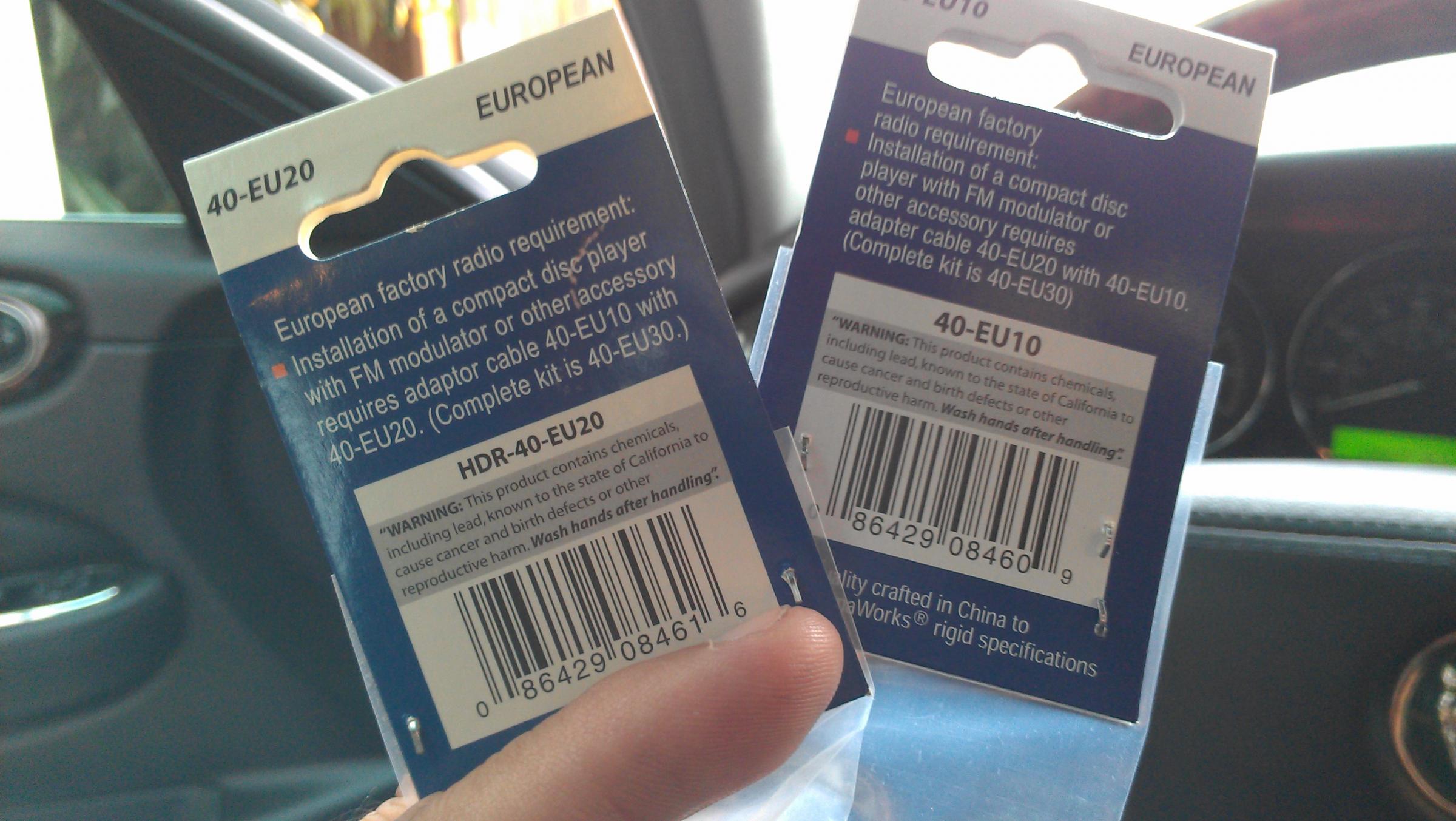

Hello i installed one the jag xj8
Fallow the instruction to remove the center counsel.
2 remove radio need to put car in D to pull out.
remove Antenna input install adaptors shown in picture to RCA jack in and out route the wires i chose the right side method under the ash tray then side by plastic ac conduct to center counsel shown in the photos took 2 hrs. Also i took 12+ from cigarate lighter in the back the right one and grounded the - on one of the bolts that hold the gear selector it came a fuse link so did not mind the out put to jock is placed in the center counsel as seen in the photos. Hope this helps some one. Also did not come with but i put 2 tex T for added strength messure before u cut or drill that u have enough of a space between a the arm rest and the plug out put so it can close.
Attached Thumbnails Another aux input option - anyone tried?-imag0779.jpg   Another aux input option - anyone tried?-imag0776.jpg   Another aux input option - anyone tried?-imag0780.jpg   Another aux input option - anyone tried?-imag0774.jpg   Another aux input option - anyone tried?-imag0781.jpg
