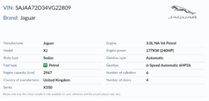

My car specs are attached in the image.... do you need any other specs, not given in the image ? Let me know, I will try to provide if not too technical.

I searched around a bit, but no luck finding any info or manuals on that particular model. Not sure if the engine is the same as US 2004 X-type v6. Hope you have better luck that I did looking for info.
If it is the same, here are some specs from that. They are 12v and 120-130amps for most of the replacements I looked at for that car.
Pulley Outside Diameter 2.3 IN
Pulley Outside Diameter58 mm
Voltage12 2
HDE to Pulley 1st Groove1.46 IN
DE to Pulley 1st Groove37.0 MM
DE to Rotor Shaft End2.28 IN
DE to Rotor Shaft End58.0 MM
Plug Clock Rear View Main Mounting Ear at 6 O Clock - 4
Terminal Connection Quantity 4
Alternator Case Material Aluminum
Finish Same as OE
Fan Type Internal
Ground Type Negative
Rotation Direction Clockwise
External Fan Included Not Applicable
Pulley Included Yes
Family Nippondenso IR IF
Pulley Groove Quantity 6
Pulley Belt Type Serpentine
Regulator Type Internal
Amperage Rating120 68
Mounting Type1 Pivot Foot

I am not from technical background, but I believe that logically the engine should be same between your country and here. Yes the difference would be in the air conditioning, and the engine cooling system. To support this, the power requirements may differ a bit, but I think Jaguar would maintain a standard range to make it easier for spares and services.
I dont know if I make any sense. But thanks a ton for this info.
