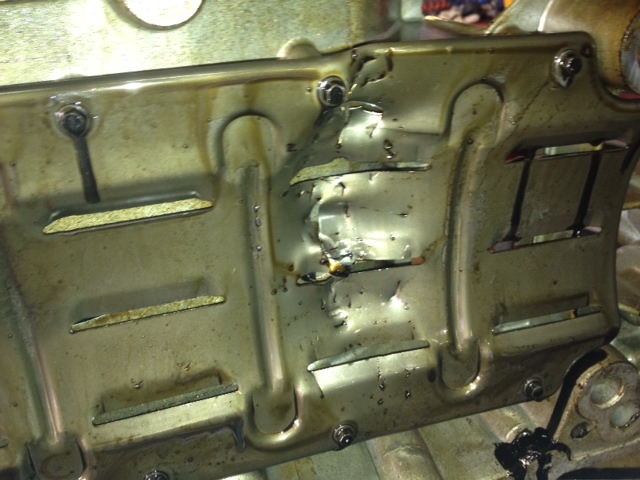

Default Blown Head Gasket / Thrown Rod
Hello All,
I just wanted to go ahead and share what transpired after I left off with my 04 XJR needing a motor. After 2 weeks of dealing with the people at Jaguar USA, they came back and said they were unwilling to offer any assistance to me whatsoever on account of my vehicle not having proper service history (complete BS, because I sent them everything from Day 1). I am completely disappointed in the brand, and sad that Jaguar clearly does not care about the retention of its clients. I really did want to be the guy to choose a Jag over a Benz, but now that I got all of the "I told you so's" from my family, and friends... I'll probably not be coming back to Jaguar ever. Unfortunate really, its a beautiful car, but more than the $10,000.00 its going to cost me to fix the car, I am saddened that the brand basically told me to **** off.
Shame on your Jaguar.
Take a look at the pics of the damage to engine, and the letter they sent me after wasting my time on account of them taking their jolly old sweet time to get back to me. Its pathetic really how they handled it.
Attached Thumbnails Blown Head Gasket?-photo-1.jpg   Blown Head Gasket?-photo-2.jpg   Blown Head Gasket?-photo-3.jpg   Blown Head Gasket?-photo-4.jpg   Blown Head Gasket?-photo-5.jpg

Old May 11, 2012 | 10:32 AM
Posts: 121,184
Likes: 6,658
Those are some sad looking pictures!
You might want to edit the attachment to remove your address.
