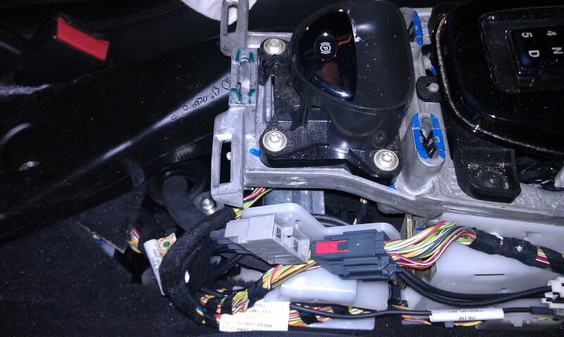

Is the phone harness the empty grey connector in this picture?

No I don't think so. My 2004 XJ came with the factory analog AT&T phone. The connector under the armrest was about 1" square. I simply removed the wiring harness and cradle and installed the BT puck. I also had to swap out the PSE module in the trunk to a later version.
