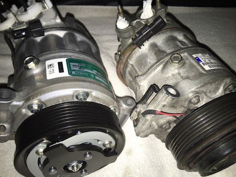

Yes your right the DPS has nothing to do with the rear AC. It was added so the AC can be more precisely controlled. Some cars have them and some don't. Easy to see by looking. The DPS makes the AC compressor run 100% of the time and is internally controlled.
My DPS failed on my 2014 XJR (No rear AC option) which lead to a long string of repairs. The short version is if you have any DPS codes or problems your FAR ahead to plan on a AC compressor replacement. The amount of work required to get to and replace the DPS is the same as a compressor replacement. Plus now you have a new one with warranty.
Interestingly my car while having the DPS also has the old style magnetic clutch!
Here is a side by side comparison. My 2014 OEM version is on the right. You can see the wires running to the clutch. The other one has no wires to the pulley. This is again another variation I had to figure out.
Next JLR has some errors in their TSB on the DPS problem. This caused me to order the wrong part. Yes there are also different versions of the DPS and they DON'T interchange! Another reason to forget the DPS and go straight to the compressor replacement.

Yes I have the later X351 model. There were more undocumented changes and it got even worse as they changed how those peanut fittings attach to the compressor AND they changed the seal assembly.
Plus they added a face O-ring to the compressor itself!
Replacement compressor has the yellow O-rings.
Here is how they changed the ends of the tubing seals. Lucky they do interchange and I have had no leaks.
The worst was they changed the distance from the stud to the AC port on the peanut fitting. This means yes the tubing fits but you can't attach it because the mounting stud has been moved! Again no mention anywhere about these changes. I sliced the back side of the tubing fitting. This made the mounting hole a slot instead. Simple mod once I looked at it.
JLR changed the hoses and the compressor (BUT not the part numbers!) so if I had also ordered both AC hoses that attached to the compressor it all would have fit together. As it was I had a leak in one hose and a DPS problems. So I had they new style compressor and one of the new style AC hoses.
But the point of all this is to CHECK your AC compressor and get a picture of the tag before ordering anything!
All these changes were done on the correct part number for my car. So be aware of undocumented changes!
